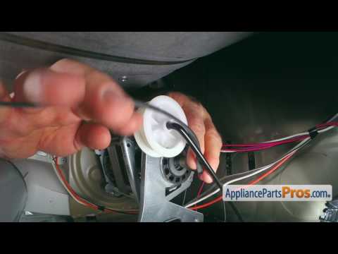

Peter K Hawthorn Woods , IL March 08, 2017 Noisy drum pulley or motor The video was quite helpful with step by step instructions. I ordered a belt and idler pulley before dismantling assuming they were the issues. Belt was easy and fit fine but I did not realize the idler pulley was secured with a special fastener, push on cap nut, that would be damaged if removed. So I left it in place. Original pulley seemed fine so I reassembled the dryer. Restarted and of course the noise remained. I ordered the push on fastener and also the drum bearing as a precaution. I suggest anyone with a noisy drum replace belt, pulley,drum bearing and the pulley fastener. May as well spend a little more parts money instead of wasting labor and extending downtime. It works great. Read More... 1 People found this story helpful Do-It-Yourself Rating: Repair Time Estimate: 15-30 minutes Tools: Screwdrivers
Dan J Oswego , NY September 30, 2020 Appliance: Model GHDN520EDOWS There was an intermittent squeak when operating The video that was available with the selection of the part was excellent. One comment, my particular machine, same model number, there were differences. The control panel was mounted differently and the tools required were different. A 3/8" nut driver and Phillips screwdriver were needed. The repair went well.When I was reinstalling the dryer drum, I first tried from the front of the machine due to the available in my laundry room. I struggled getting it aligned properly and could not get the shaft aligned. I then stood to the side of the machine, and I easily installed it. From the side is as it is shown in the video. Read More... Do-It-Yourself Rating: Repair Time Estimate: 30-60 minutes Tools: Nut Drivers, Screwdrivers
Jaylene N Kaunakakai , HI September 23, 2017 Belt needed to be replaced. Watched a YouTube video that I think was posted by Appliance Parts Pros, and was able to take apart dryer and replace belt and idler pulley with ease. I put the cap on using pliers and a hammer- nut wouldn't just push on, it needed a little coaxing. Read More... Do-It-Yourself Rating: Repair Time Estimate: 15-30 minutes Tools: Pliers, Screwdrivers
Charles K Odessa , TX February 23, 2015 Appliance: Model DBLR333EE22WW Pulley was wobblie Removed the drum, belt and replaced the pulley and retainer nut Read More... Do-It-Yourself Rating: Repair Time Estimate: Less than 15 minutes Tools: Pliers, Screwdrivers
Pauline M East Montpelier , VT January 18, 2017 Appliance: Model DBRX463ED 7WW After replacing rear bushing dryer still made noise so i ordered idler pully i watched how to video and the fix was less than20 minutes thanks for going the extra mile! service is a+ I followed Video instructions. I even noticed that the service Rep was wearing gloves. That's when I realized that the inside tin is very dangerous. I had no problems at all with switch over. Thanks Guys!!!! Read More... Do-It-Yourself Rating: Repair Time Estimate: 15-30 minutes Tools: Nut Drivers, Screwdrivers
