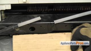

James L Bellevue , KY May 16, 2019 Appliance: General Electric Refrigerator PSCS3RGXCFSS A water leak under a GE side by side refrigerator Our adventure started with stepping in a wet spot in the carpeting in a bedroom adjoining the kitchen. The wet 'spot' turned out to be a wet 'section.' WTH?!? Pulling out the nine-year-old GE side-by-side refrigerator revealed the answer, something leaking big time under that fridge. We suspected the ice maker since we now hear water flowing when the ice cube tray replenishes. However trial & error showed the leak correlated with using the in-door water dispenser. At least we had stopped the leak. Ice maker, refrigerator/freezer still worked fine. A look on-line offered one good repair video for a specific issue involving the water dispenser supply line, but little about the routing of that water line. Then a nephew very skilled in home repair introduced us to AppliancePartsPros.com. There we found videos that showed the path of those water lines and a specific one of 'Reba' analyzing the supply line to the water dispenser and how to remove/repair a leaking section along with the parts needed. Bingo! And right next to the video were listed the parts required making it easy to put those items 'in the cart' and complete the order. In our case, the leak came from a portion of the tubing in contact with the compressor (brilliant design, GE!) which became brittle and eventually burst Even with standard shipping the parts arrived in four days. The repair took me a few minutes longer than Reba's work, but I was careful to route the new tubing as far from that compressor, or anything else hot, as I could. So far, so good. Many thanks AppliancePartsPros.com. Read More... 106 People found this story helpful Do-It-Yourself Rating: Repair Time Estimate: 15-30 minutes Tools: Nut Drivers, Screwdrivers

Laura F Steamboat Springs , CO October 24, 2017 My ge refrigerator was not dispensing water through the door it was making and dispensing ice but no water I first went on line and through YouTube found several possible causes- frozen water line in Freezer door, leak in cold water tank in the refrigerator, problem with the water-tank to freezer door water line. Per video instructions, I pulled the bottom on the refrigerator and found that the water fine from the tank to the freezer door had broken. An on-line chat with an AppliancePartsPros representative lead me to the correct parts and the video on how to fix my specific problem. Repair was quick and easy - all I needed was a screw driver and a razor blade and the Water Tank Tube and Union Connector which ordered and the repair itself took 30 min. Great to have water from the refrigerator again. Read More... 356 People found this story helpful Do-It-Yourself Rating: Repair Time Estimate: 30-60 minutes Tools: Screwdrivers
Charles R Whiting , NJ November 23, 2014 Water leak The tube running through the freezer door was leaking so I ordered a new one and connector carefully removed trim, took out the six screws holding the control mod and dispenser, removed old hose inserted new one put on new connector put everything back, walla no more water on floor. Read More... 39 People found this story helpful Do-It-Yourself Rating: Repair Time Estimate: 30-60 minutes Tools: Pliers, Screwdrivers
