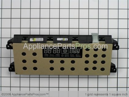

Part Number: OEM9634035
Manufacturer Part Number: 316207603
This control board manages oven functions and displays time, located behind the front control panel of the range. Replace if oven functions don't work, the clock display is blank or incorrect, or if the oven won't heat or maintain proper temperatures.
