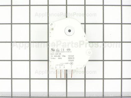

Nes February 16, 2023 for Model Number MCBR1010W My defrost timer is bad, it sticks and i have to turn it manually to get freezer to defrost. The part, cf200356 is no longer available. Wiring is 1-white, 4-blue, 3-yellow, 2-pink. Is there a compatible replacement part available? Yeah, I could replace the frig but it's a built in in my vintage trailer and we have all of our travel decals/stickers on the doors and hate to part with the frig.
1 Answer Nes,This part has been discontinued by the manufacturer & is no longer available.No alternate or substitute part has been recommended by the manufacturer. Read More...
William July 05, 2017 for Model Number Magic Chef Refrigerator Model RB19K-4A Need a defrost timer : Wires coming out to make contact with timer are Blue, Orange, Brown and Yellow. Blue wire is the seperated terminal in the timer. Also where will the loose black wire on the timer go #1 or #2 terminal on timer? Many Thanks
1 Answer Hello William. The black wire that was included with the kit would only be used if you had a three wire set up and needed a jumper wire. You should connect your wires to the same number you disconnected them from. For example, orange would go to #3, blue to #4, yellow to #1 and brown to #2, hope this helps! Read More...
Walter O July 04, 2017 for Model Number Magic Chef RB19K-4A refrierator Defrost timer Provide me with the proper part number defrost timer for this unit: Wire colors in connector: 1=white, 2=yellow, 4=orange, 3=blue Also if this timer comes with a loose black wire which terminal does it connect to.!! thanks
1 Answer Walter, The "original" defrost timer has been discontinued by the manufacturer. It has been replaced by a "universal" direct replacement part WP4391974 / WP4391974. The replacement part will contain instructions, wiring information to convert and install the defrost timer in your machine. The part is in stock and available at this time. Thanks, Read More...

Gerry September 20, 2014 Hello, I have received this part and have installed it. However, after several days of monitoring, the new timer is not advancing. Is there something else that needs to be checked? Or did I receive a defective defrost timer? If you require additional information, please let me know. I look forward to hearing from you soon. Thanks Gerry B
1 Answer Gerry, To properly assist we would need to have the model number of the refrigerator. Please post your model number with a new question on the parts page. http://www.appliancepartspros.com/modelnumber_locator.aspx Read More...
Gerald M March 31, 2014 for Model Number mcbr1010w If I move the defrost timer manually and it doesn't go into defrost mode is that just because the timer is bad or something else also?
1 Answer Hello Gerald. If the unit is not defrosting, you will need to check the timer, thermostat, and heater in the unit. You can test this with a multi-meter TJMA-DMT3. Here is a link on how to use a multi-meter. http://forum.appliancepartspros.com/oven-repair-including-ranges-cooktops/4810-how-check-continuity-ohmmeter.html Read More...
Victor February 23, 2014 for Model Number defrost timer#AP4565266 (CF2003-56) for magic chef MCBR1010W Hello. I recently installed my defrost timer but still the freezer won't stop to defrost. I have already been explained that it could be the thermostat or defrost heater, but before checking these parts I want to be sure I have installed the wiring correctly. I plugged it in first the same way the previous one was installed (not original and installed by someone whose expertise I now doubt) and then by color scheme the timer shows. None of them worked. Could it be that I did not plug it n correctly? Victor
1 Answer Victor, The wiring of the timer should be as follows, terminal 1 should have a white wire attached, terminal 2 should be a pink, the number 3 terminal is yellow and the number 4 terminal is blue. If it is wired this way then the issue would be the thermostat or the heater. Read More...
