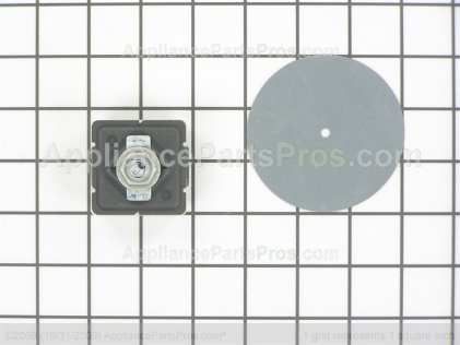

Riad August 29, 2025 for Model Number C-101 Does the surface unit switch kit by Whirlpool work or replace the surface unit switch of Jenn-Air C-101 serial number 208947RR?
1 Answer Hi Riad, thanks for contacting AppliancePartsPros.comSurface unit switch 700855K is the correct infinite switch for this model. Read More...
1 Answer Hello Jason,as listed in the part description, for part 700855K,'This top burner switch has a push to turn D shaped shaft. Includes mounting nut, gasket and instructions. For the double flat shaped shaft switch order W11120795." Read More...

Dick October 23, 2021 for Model Number Jenn air C221 I have ordered and received part 700855k which is the right part. However, the wire configuration is different from the earlier part to be replaced. How do I determine which wire to which post?? .
1 Answer Dick, the double black wire will go to L1, double red wire to L2, orange wire to P, brown wire to H1, and violet wire to Hc. Read More...

Garry May 15, 2020 for Model Number Jenn-Air cook top model C-301 Ordered part # AP4087111 to replace existing switch but can't figure out the purpose of the circular rubber with hole in the middle. Is there a video showing replacement of switch on a cook top stove?
1 Answer Hello Gary,unfortunately, there is no video for this part. The manufacturer supplies this switch as a kit, on some cooktops, there is a rubber seal that is used on the switch shaft to prevent liquids, debris from falling down onto the switch itself, if the original switch did not use one,then it is not needed. Read More...
