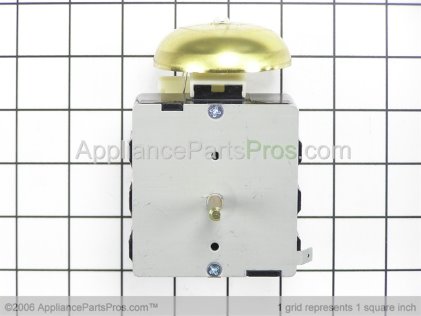

Brian July 03, 2013 for Model Number MDE7600AYW My Maytag dryer works great with the exception of the dryer will never shut off. The timer knob never moves when you start the dryer, so if you start it on high it will remain on high until you manually shut off the unit. I am assuming part number AP4043866 is the obvious fix but I just wanted to confirm?
1 Answer Hello Brian. If there is power to the timer motor, and the timer does not advance, you will need to order and replace the timer on the unit. You can test this with a multi-meter TJMA-DMT3. Here is a link on how to use a multi-meter. http://forum.appliancepartspros.com/oven-repair-including-ranges-cooktops/4810-how-check-continuity-ohmmeter.html Read More...

Mark August 18, 2012 for Model Number MDE6000AYW The timer on our dryer has "M460GB" and "Maytag" printed on it. Does your Item Number: AP4043866 Manufacturer's Number: 33001932 replace it? Thanks.
1 Answer Hello Mark! According to your model number the timer, part number WP33001932, is the correct replacement for your unit. Thanks! Read More...
