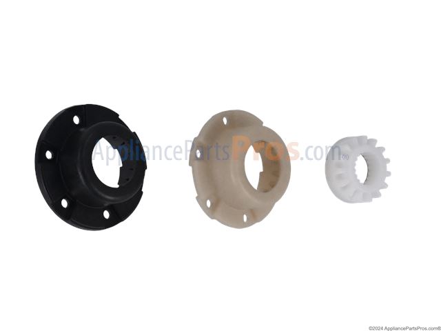

Thomas L Beachwood , NJ August 11, 2020 Appliance: Maytag Washer MVWX655DW1 Agitator slipping, clothes not spinning out properly and we’re soaking wet. Called Appliance Parts Pros and again they nailed the problem on the head-replaced hub under agitator-machine now works fine-they have helped me repair 3 different appliances in my home. Read More... 2 People found this story helpful Do-It-Yourself Rating: Repair Time Estimate: 15-30 minutes Tools: Screwdrivers, Socket Set
Paul F Hawley , TX December 27, 2022 The agitator gear worn code s2 or 52 (display had to tell) basket wouldn't spin. I replaced the drive gear again. I replaced the gear back in the summer, but apparently, the screws had backed out a little and it was enough to make the drive shaft chew up the gear. Going forward I'm going to periodically check the screws and if they start backing out again I may put some blue Loctite on them. I can't understand why plastic drive gears are used in a high efficiency washing machine. Read More... Do-It-Yourself Rating: Repair Time Estimate: 15-30 minutes Tools: Screwdrivers, Socket Set
