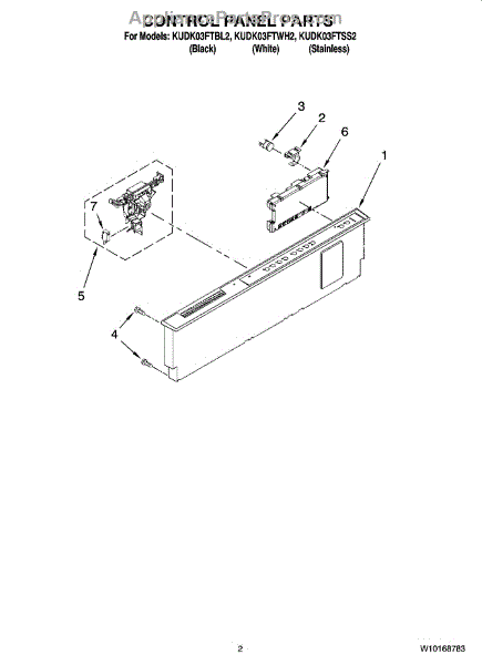

Ruben M Naperville , IL April 21, 2014 Appliance: Whirlpool Undercounter Dishwasher DU1300XTVB1 When the dishwasher would start it's wash cycle the motor would start for a second and turn off I initially purchased a door switch, thinking that it would solve the problem. I replaced the switch by removing the top 6 star screws, removing the component cover and removing one of the door switches (using a 3/16 socket) with the new one that I bought but I still had the problem. Looking at the schematic, the next part that needed to be changed is the electronic control board, which I purchased. I removed the same screws again and cover, used a screwdriver to pull back the clips holding the board, removed the connections one-by-one from the old board and reconnected them to the new board. Put everything back together, tested it and now it works like new. Read More... 19 People found this story helpful Do-It-Yourself Rating: Repair Time Estimate: Less than 15 minutes Tools: Nut Drivers, Screwdrivers, Socket Set

Stephen B Charleston , SC October 20, 2014 Appliance: Model 665.13463K900 Normal cycle light blinking kenmore model 665 13463k900 I repaired this dishwasher in less then 30 mins, with the help of my 9 year old son. He actually did almost all of the work. Together we replace the Control panel. My son removed the 6 screws holding the panel on the door, then removed the latch mechanism, then the electronic control cover (this required a little help from me), the I removed the electronic control. Reinstalled in the opposite order. My son needed a little help getting the parts properly aligned. Over all this is a repair anyone can do. I use the form here for troubleshooting help. Read More... 1 People found this story helpful Do-It-Yourself Rating: Repair Time Estimate: 15-30 minutes Tools: Screwdrivers
