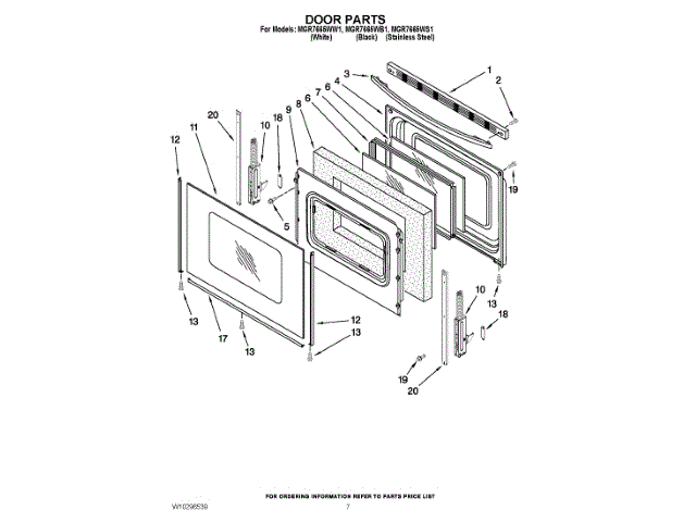

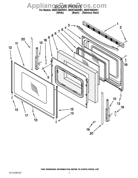

Mitch S Mount Laurel , NJ January 21, 2019 Appliance: Whirlpool Electric Range WFE515S0ES0 Oven door will not shut completely I knew for sure that the hinge with the large spring was damaged, but elected to replace both hinges and receivers. Replacing the parts was fairly easy and would have taken me less then an hour. This model has thin metal covers over the hinge assemblies. I found that squeezing in the sides of the covers help to hold them in place on the hinge while reassembling the door. My only difficulty was putting the door back on the oven. It took a little maneuvering but I managed to get it. Now the door not only closes completely, but it opens more smoothly then before. Thank you to AppliancePartsPros for making it easy to order these parts and the support available. Read More... 19 People found this story helpful Do-It-Yourself Rating: Repair Time Estimate: 30-60 minutes Tools: Pliers, Screwdrivers
Caleb L Chicago , IL August 31, 2020 Bent oven door hinge. Purchased replacement parts. Began taking oven door apart to get at the hinges. Unfortunately the door is held together with magic. Once you remove a few of the screws everything just falls apart. It seems that pressure and the very tight tolerances make the door very sturdy but once you start removing pieces the integrity of the door just goes away. Putting it back together was very challenging. But my wife and I were able to get it accomplished. Not an easy task to say the least. Read More... 9 People found this story helpful Do-It-Yourself Rating: Repair Time Estimate: 2+ hours Tools: Screwdrivers
Andrew H South Bend , IN December 03, 2018 Broken oven door hinge The fix involved removing the oven door, taking the door apart, removing the old hinges, screwing the new hinges into place, and putting the door back together. The hardest part of the repair was just getting the door back together correctly. Replacing the hinges was easy. Read More... Do-It-Yourself Rating: Repair Time Estimate: 30-60 minutes Tools: Screwdrivers
Janet H Henning , MN December 19, 2019 Bent oven door hinge door wouldn't open and or close properly I ordered replacement hinges (2) one for r and one for l . My boys took door off and repaired it. It took a bit to get hinge to fit properly but they did it. Should have taken a picture to know how to put back together (many screws) but they got it fixed and it is good now. Read More... Do-It-Yourself Rating: Repair Time Estimate: 30-60 minutes Tools: Screwdrivers
Anthony Z Wilkes-Barre , PA October 26, 2020 Broken range door hinge Removed door from range, disassembled to access broken hinge, replaced with new hinge, reassembled the door, reattached to range. Read More... Do-It-Yourself Rating: Repair Time Estimate: 15-30 minutes Tools: Screwdrivers
