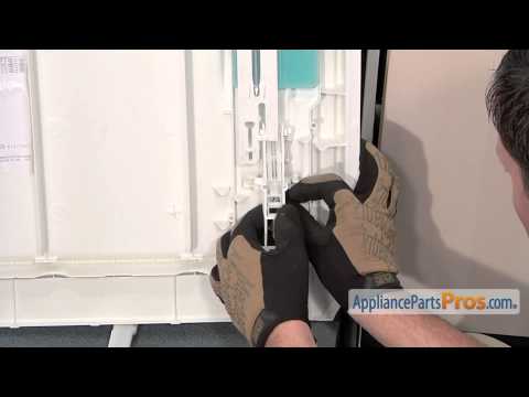

James G Waxhaw , NC January 12, 2015 Appliance: Whirlpool Undercounter Dishwasher DU909PWKQ0 Latch would not open consistently on detergent dispenser Appeared to be two problems: the latch was worn and one of the pins that slid in a guide on the actuator located in the inner panel had broke off. Detergent lid spring and pin appeared to be OK but decided to replace since I was aready working on it. I ordered all the inner panel mechanism from the control arm to the latch actuator on the inner panel. The repair was successful as the detergent dispenser now opens during its cycle. Read More... 68 People found this story helpful Do-It-Yourself Rating: Repair Time Estimate: Less than 15 minutes Tools: Pliers, Screwdrivers

Wen S Westminster , CO July 12, 2015 Appliance: Whirlpool Dishwasher DU960PWKT1 Whirlpool quiet partner ii dishwasher soap dispenser door latch broken Bought the latch kit and replaced both components. There are two pieces, one long piece and a small snap piece. 1. First, pull out the broken door latch component located at the bottom of the soap dispenser. 2. Take out all the screws holding the inner dishwasher door panel. Once the screws are all out, this panel could be flipped over to reveal the "under" side. 3. There's a rectangle plastic cover protecting the soap dispenser door opening mechanism on the 'under" side of the dishwasher's inner door panel, just slide it out so you can reach in to remove the other broken door latch component. 4. The long piece from the latch kit fits in directly from the soap dispenser side and snaps right into the shorter receptacle piece that has to be placed in the "under" side of the inner dishwasher door panel. 5. Replace the rectangle plastic protecting cover 6. Put all the screws back. 7. Done. Read More... 3 People found this story helpful Do-It-Yourself Rating: Repair Time Estimate: Less than 15 minutes Tools: Pliers, Screwdrivers
