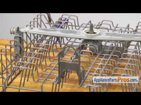

Julie M Fair Oaks , CA February 14, 2015 Dishwasher top shelf rack Ordered necessary parts. Parts were received the next day!! Read More... 2 People found this story helpful Do-It-Yourself Rating: Repair Time Estimate: 15-30 minutes Tools: Screwdrivers
Russell A Brentwood , NY April 06, 2014 The original part melted! I looked carefully at the online diagram, and matched it up. I had to remove the plastic piece it fit into in order to align it properly. Read More... 1 People found this story helpful Do-It-Yourself Rating: Repair Time Estimate: Less than 15 minutes Tools: Pliers
Ethan G Moorestown , NJ April 19, 2020 Glasses were coming out with particles in them, manifold had corroded through in several areas. Replace the entire assembly, manifold, spray arm with seal and water probe. Took 5 minutes. Problem solved! Read More... 1 People found this story helpful Do-It-Yourself Rating: Repair Time Estimate: Less than 15 minutes Tools: Screwdrivers
Thomas R San Antonio , TX August 25, 2017 Appliance: KitchenAid Undercounter Dishwasher KUDS50FVSS3 Not washing thoroughly and leaving glassware etched/stained 'jet dry' fluid was only lasting 2 loads after being filled Disassembled and removed filter hoping to find lots of junk to remove. There was none (I had cleaned this area a year ago). Looked at everything I took out. The Feed tube assembly has two rubber pieces that appear to act as stoppers. One of the two was missing. The spinner at the top of the Feed tube was clogged.I ordered the Feed Tube Assembly which included the spinner and had the new rubber pieces. The water manifold probe has a plastic piece at the end that was bent to one side. Although I could bend it back, I still purchased a new one. I replaced the soap and fluid dispenser with a new model. Waited what seemed like 6 hours but was actually two days for parts to come in from Appliance Parts ProS! Installed everthing that night and it seems to be cleaning and dispensing the proper amount of fluid (at least 3 loads now and the needle moved appropriately.....and did not dump the entire dispenser in two loads. The most difficult part of the repair is replacing the dishwasher front panel which needs to be removed to replace the dispenser. Frustrating but slow down and take your time, it will eventually go back on. Two people might make this easier but in my case it was just me. Read More... 1 People found this story helpful Do-It-Yourself Rating: Repair Time Estimate: 2+ hours Tools: Nut Drivers, Pliers, Screwdrivers
Matthew H Cocoa , FL June 06, 2018 My dishwasher though new and ridiculously expensive was failing to clean anything on the top rack. I purchased the parts indicated on this review and... well the dishwasher is working fine now. I cannot complain about the quality of the parts, everything worked extremely well. I do feel like I would have spent less money just buying a new dishwasher. Read More... 1 People found this story helpful Do-It-Yourself Rating: Repair Time Estimate: 30-60 minutes Tools: Screwdrivers
