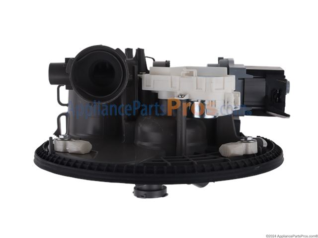

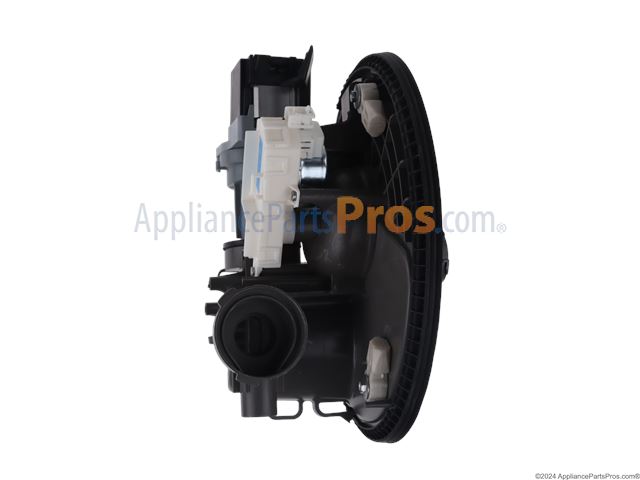

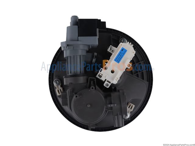

Peter M Warwick , RI August 24, 2025 Appliance: Model KITCHEN AID DISHWASHER Washability problem no wash pump operation all other functions working drain drying cycling etc Ordered the sump and the motor assembly. The price was reasonable and the delivery was next day! Disconnect power at circuit breaker, disconnect power, drain line and water line. Remove necessary fasteners to remove D/W from cabinet. Flip upside down and remove all wired connections to sump pump motor assembly. Take a picture before disconnecting all of them for reference if needed.. Remove stabilization weight, drain pump, and drain line. Remove sump and motor assembly, only 3 swing fasteners. Install the new motor pump assy and reverse as above. install in cabinet, reconnect and test run for leaks. The problem with the wash pump is the wearing of the shaft bearings to a point where the rotor gets stuck to the side of the bore due to the magnetic pull of the stator. Motor may be intermittent at times or completely stall. The motor sump assembly is cheaper than the pump motor alone.Total time was diagnosis , disconnect, replace part(s), reinstall, test.You could skip removing the door panel and checking the fuses.If the wash function fails then it's usually the the pump (after 5 years, depending on your frequency of use).. At your own risk, you can apply 120vac directly to the motor leads for a test, this is a duty cycle motor, be aware not to leave it under power for a long time. This may be possible to replace the motor sump without removing the D/W from cabinet, but from past experience, working from inside the D/W is not desirable. The cabling may not provide adequate slack and clearance for disconnecting the wire harness connections. Better done bottom up out of the cabinet Thanks appliance parts pro that was fast delivery! Read More... Do-It-Yourself Rating: Repair Time Estimate: 1-2 hours Tools: Adjustable Wrench, Pliers, Screwdrivers, Socket Set

Wmdean W Franklin , VA November 10, 2025 My whirlpool dishwasher stopped washing there was no water flow coming into it during the cycle I called an appliance repair tech, who determined that the Sump and motor had failed. He said the repair with parts and labor would cost almost as much as a new dishwasher. He provided me with the part number to look for and I ordered Whirlpool W11665769 Sump And Motor Assembly OEM Part. It arrived within two days and using the linked video I was able to removed the failed assembly and install the new assembly with relative ease. The video was easy to follow, no special tools needed. The part was $100 less than quoted by the repair tech. I saved at least $300 total by buying from AppliancePartsPro.com and installing it myself. Read More... Do-It-Yourself Rating: Repair Time Estimate: 30-60 minutes Tools: Pliers, Screwdrivers
Dennis Q Midland , MI December 27, 2025 Appliance: Model KDFE104HBL0KITCHENAID DIAHWASHER 43 I spoke with a local sales/service dealer and they told me that they would replace the entire sump/motor assembly unit versus the single part as they have fewer leaks when they do it that way. So I ordered the whole lower unit. I watched your video on replacing the entire unit that was very beneficial. Repair went well and no leaks. Dishwasher works well!!! Thanks!!! Read More... Do-It-Yourself Rating: Repair Time Estimate: 2+ hours Tools: Nut Drivers, Pliers, Screwdrivers
