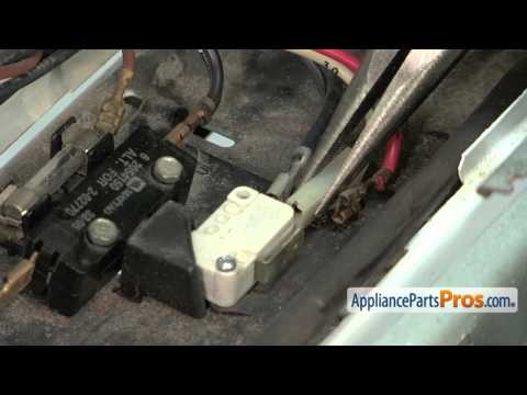

Michael D Ambler , PA November 03, 2014 Appliance: Model MAYTAG OLD MODEL 1993. Lid switch washer Lid switch problem. Easy to fix, not so easy to diagnose. First thing to look at if something goes wrong and there does not appear to overtly be mechanical issue like pump, etc. Read More... 48 People found this story helpful Do-It-Yourself Rating: Repair Time Estimate: 15-30 minutes Tools: Nut Drivers, Pliers, Screwdrivers

Mark C New Bedford , MA March 08, 2015 Lid switch Video. Took2 minutes Read More... 2 People found this story helpful Do-It-Yourself Rating: Repair Time Estimate: Less than 15 minutes Tools: Pliers, Screwdrivers
