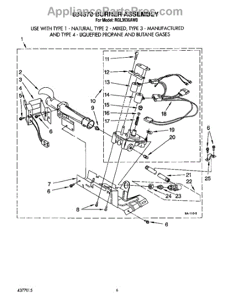

Parts for Roper RGL3636AW0: 04 - 694670 Burner Assembly Parts
