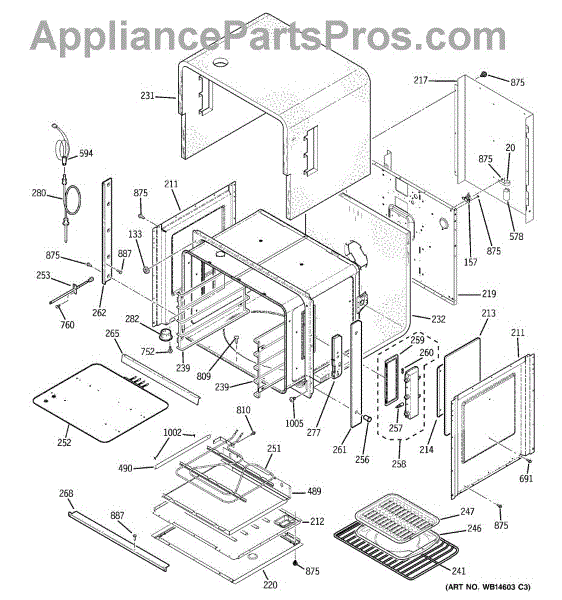

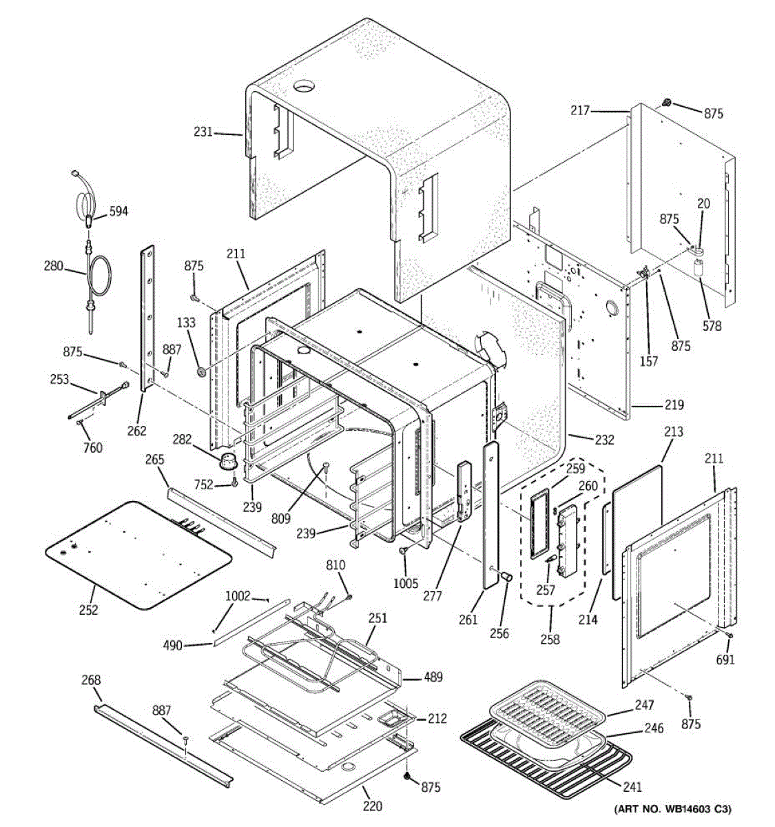

Part Number: WB02T10194
Mounting bracket that secures the capacitor to your range frame. Replace if bent, broken, or missing to properly support and position the capacitor.
$3.96
133
Part Number: WB01T10022
Small rubber bumper that cushions contact between oven door and cabinet. Replace if cracked, missing, or worn to reduce noise and protect finishes.
$7.18
157
Part Number: WB24T10081
Oven won't heat or shuts off after reaching temperature? The hi-limit thermal switch prevents overheating. DIY repair takes 30-60 minutes.
$38.95
211
Part Number: WB02T10284
Insulation retainer clip secures insulation panels inside your oven cavity. Replace if clip is broken, cracked, or missing to keep insulation in place.
$61.55
212
Part Number: WB02T10372
$78.84
213
Part Number: WB35T10136
$47.65
214
Part Number: WB02T10309
$22.03
217
Part Number: WB02T10373
$27.83
219
Part Number: WB02T10388
$44.31
220
Part Number: WB02T10502
$56.77
231
Part Number: WB35T10184
$93.21
232
Part Number: WB35T10127
$65.32
239
Part Number: WB48T10041
Replaces worn or damaged oven rack guide assembly. Restores smooth rack sliding and proper alignment. Needed when guides are cracked, broken, or missing.
$154.64
241
Part Number: WB48T10109
246
Part Number: WB48T10090
Large broiler pan with grid for ovens and ranges. Replaces damaged, warped, or missing pans. Installs in broiler compartment for cooking meats and vegetables.
$32.44
247
Part Number: WB48T10089
Replacement broiler pan that installs in your oven cavity. Needed when original pan is warped, rusted, damaged, or missing from your appliance.
$46.27
251
Part Number: WB44T10056
Fix uneven baking and undercooked centers by replacing your failed lower bake element. Restores consistent bottom heat for proper oven performance.
$105.14
252
Part Number: WB44T10057
Oven not heating properly or broiler not working? This broil heating element restores even high-heat cooking. Common DIY repair, typically installs in 30-45 minutes.
253
4.9 (76)
Part Number: WB23T10015
Fix F2 or F3 error codes with a new oven temperature sensor. Restores accurate heating when your oven shuts off or won't maintain temperature. 10-15 min DIY.
$32.95
256
Part Number: WB01T10107
Retainer bolt secures internal components and panels in your range or wall oven. Replace if bolt is stripped, missing, or causing loose assemblies.
$11.90
257
Part Number: WB25T10064
Restore bright, clear visibility inside your oven with this 20-watt halogen light bulb. Replace a burned-out bulb to monitor cooking through the window and safely see racks and dishes without opening the door. What it does:
  • Illuminates the oven cavity when the light switch is used or the door is opened
  • Helps you check cooking progress and locate items inside the oven
  • Common symptoms: interior light won't turn on, is dim or flickers, or the bulb glass is broken
  • 20-watt halogen design matches the original lighting specification
  • 1 halogen light bulb
  • Disconnect power at the breaker and allow the oven to cool completely
  • Wear gloves or use a clean cloth; avoid touching the glass envelope
  • Remove the lens/cover per your model instructions; carefully remove the old bulb and fully seat the new bulb
  • Reinstall the cover, restore power, and test; use only the wattage/type specified for your appliance
$15.84
258
Part Number: WB25T10061
Replace your burned-out or dim oven interior light bulb assembly to restore bright visibility while cooking. Confirm fit with your model number.
$157.69
258
Part Number: WB25T10062
Halogen light bulb assembly for your oven. Replace when light dims, flickers, or burns out to restore interior visibility. Verify fit with your model.
$169.07
259
Part Number: WB25T10063
This is a glass crystal lamp lens or cover that protects the oven interior light bulb from heat, grease, and direct contact with food. It fits over the light socket inside the oven cavity. Replace it if the lens is cracked, chipped, cloudy, or missing - a damaged lens can expose the bulb to harsh oven conditions and reduce interior visibility.
$66.77
260
Part Number: WB02T10297
Secures oven door glass to the door frame, preventing rattling and separation. Replace if glass is loose or vibrating. Confirm fit with your model number.
$7.20
261
Part Number: WB07T10538
$12.52
262
Part Number: WB07T10641
$174.95
262
Part Number: WB07T10642
$183.60
265
Part Number: WB02T10458
Air divider panel for ovens. Installs inside the oven cavity to direct airflow properly. Replace if cracked, warped, or missing to restore ventilation.
$99.42
268
Part Number: WB07T10615
277
Part Number: WB10T10117
Hinge receiver bracket that mounts to the oven frame and secures the door hinge arm. Replace if cracked, stripped, or damaged to restore proper door support.
$24.01
280
Part Number: WB20T10023
This probe thermistor monitors interior temperature and sends readings to the control board so your appliance can maintain the correct cooling cycle. It replaces a failed or inaccurate sensor to help restore proper temperature regulation. What it does:
  • Senses air or evaporator temperature and reports it to the control module
  • Commonly related to warm/freezing issues, incorrect temperature readings, or erratic cycling
  • Used by the control system to trigger fans, defrost, and compressor operation as needed
  • Works as a direct replacement for the listed OEM temperature probe
What's included: One probe thermistor (single sensor) Install notes:
  • Disconnect power before replacing to avoid shock or damage
  • Handle the sensor tip and wiring gently to avoid damage to the element or insulation
  • Route and secure the wiring so it does not contact moving parts or hot surfaces
$85.59
282
Part Number: WB28T10215
Channels exhaust air from your wall oven to maintain proper ventilation. Replace this vent tube assembly if damaged, cracked, or disconnected for correct air discharge.
$42.95
489
Part Number: WB49T10012
$56.96
490
Part Number: WB49T10013
$11.38
578
Part Number: WB27T10662
The Wall Oven Capacitor Motor is an OEM part for GE wall ovens. Located inside the oven cavity, this motor is responsible for turning the convection fan which circulates hot air for even baking and roasting.
Symptoms of a bad capacitor motor include:
  • Inability to select convection bake or roast features
  • Uneven cooking results
  • Lack of air circulation inside the oven
  • Strange noises coming from the fan/motor area
  • The convection fan not turning on
Causes of failure can be wear over time, damage from debris inside the oven, or occasional voltage fluctuations which can degrade motor components.
$7.18
594
Part Number: WB18T10377
Wire harness that connects the meat probe to your oven's control system. Replace if wiring is frayed, damaged, or connection fails to read probe temperature.
691
Part Number: WB1K5162
This is a replacement black screw used to secure interior or exterior appliance components. It provides a discrete, color-matched fastener to restore proper fit and stop rattles or loose panels. What it does
  • Fastens trim, panels, brackets or control components where a small black screw is required
  • Restores secure mounting to eliminate vibration, rattling or misaligned parts
  • Matches finished appliance surfaces for a clean, unobtrusive look
  • Simple hardware replacement for small fastener loss or damage
  • One black screw
  • Use the correct screwdriver to seat the screw; avoid overtightening to prevent stripping or cracking surrounding material
  • Keep track of small fasteners during disassembly and handle with care
  • Replace with the exact part number if the original screw is damaged or the thread/length differs
752
Part Number: WB1K5200
760
Part Number: WB1X536
$18.25
809
Part Number: WB1X1137
810
Part Number: WB01T10072
$4.81
875
4.5 (6)
Part Number: WH2X930
Black. 8-18 AB HXW 3/8
887
Part Number: WB1K5173
Black trim screw secures exterior trim and panels on ovens and ranges. Replace missing, stripped, or corroded screws to restore proper fit and finish.
1002
Part Number: WB01T10017
Replacement screw secures panels, brackets, and trim inside your oven or range. Restores tight fit when original hardware is missing, stripped, or damaged.
$11.86
1005
Part Number: WB01T10008
