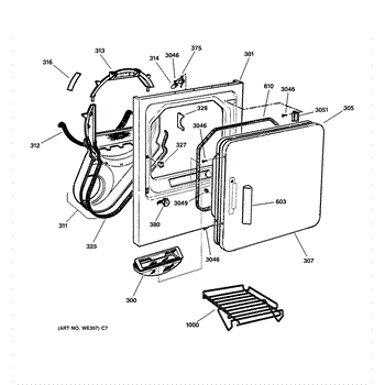

300
4.9 (202)
Captures lint and debris to maintain airflow and drying efficiency. Replace if cracked, torn, melted, or warped. Confirm fit using your model number.
$60.95
$73.14
$12.19
301
$10.93
$12.02
$1.09
301
305
Replaces damaged outer and inner door panels to restore appearance and maintain proper door alignment. Replace if panels are cracked, warped, or dented. Verify fit with your model number.
$258.50
$288.83
$30.33
307
$86.58
$95.24
$8.66
311
4.8 (185)
Unusual noises or vibrations during the drying cycle Causes of a faulty lint chute assembly can include normal wear and tear over time, clogging due to excessive lint accumulation, or physical damage due to improper cleaning or maintenance. This GE replacement part is also compatible with Hotpoint, RCA, and some Kenmore dryer models.
$82.54
$97.40
$14.86
312
4.9 (335)
Seals the gap between the drum and front panel to prevent air leaks and noise. Replace if worn, damaged, or causing squeaking sounds. Verify fit with your model.
$34.52
$41.42
$6.90
313
4.9 (308)
Supports the front of your dryer drum for smooth, quiet rotation. Replace if you hear squeaking or grinding noises. Confirm fit with your model number.
$44.95
$53.94
$8.99
314
4.9 (194)
Illuminates your dryer drum for better visibility when loading and unloading clothes. Replace when burned out or flickering. Verify fit with your model.
$16.37
$19.48
$3.11
316
4.9 (1069)
The Dryer Front Bearing Drum Slide (Green, 2-Pack) is an OEM replacement part for GE dryers. These slides are located on the front panel of the dryer and work to support the drum as it rotates. The green slides are designed to reduce friction between the drum and the panel, ensuring smooth operation and helping to prolong the life of the appliance.
Over time, these slides can wear out due to constant movement, heat, and friction. When worn or damaged, the drum may not rotate as intended, leading to noise and reduced efficiency.
Symptoms of bad dryer front bearing drum slides include:
  • Squeaking or grinding noises during operation
  • The drum appearing loose or sagging at the front
  • Clothes not drying evenly or taking longer to dry
  • Visible wear or thinning on the existing drum slides
$19.95
$23.54
$3.59
316
4.9 (1064)
The Dryer Front Bearing Drum Slide (White, 2-Pack) is an OEM replacement part for GE dryers. These slides are located on the front panel of the dryer and work to support the drum as it rotates. The white slides are designed to reduce friction between the drum and the panel, ensuring smooth operation and helping to prolong the life of the appliance.
$16.60
$2.65
325
4.9 (66)
Seals the lint screen housing to prevent lint bypass into internal components. Replace if lint escapes or seal is worn. Confirm fit with your model.
$12.46
$2.49
327
5.0 (28)
The Door Latch is an OEM part for GE dryers. This part ensures the dryer door stays securely closed during operation, activating the safety switch to allow the dryer to operate. The latch mechanism engages with the door strike to lock the door, preventing it from opening while the dryer is running, which is essential for both safety and proper functioning of the appliance.
Causes for replacement can include normal wear and tear, accidental damage, or a misalignment that prevents the door from securely latching.
Symptoms of a bad Door Latch include:
  • The dryer door doesn't stay closed during cycles.
  • Difficulty in starting the dryer due to the door not activating the safety switch.
  • Visible wear or damage to the latch mechanism.
$20.17
$3.22
328
375
380
4.9 (46)
Dryer won't start or humming when you press start? The door switch signals when the door is closed. Easy 15-minute DIY repair with basic tools.
$31.95
$38.02
$6.07
603
The Handle Door is an OEM part for GE dryers. This door handle allows for easy opening and closing of the dryer door, providing a secure grip to access the drum.
Common causes for door handle failure include regular wear from frequent use, forceful handling, and material fatigue over time.
Symptoms of a failing Handle Door include:
  • Cracks or breakage in the handle
  • Handle becoming loose or detaching from the door
  • Difficulty in opening or closing the dryer door
  • Visible wear that could affect the grip or usability
610
4.9 (11)
1000
Shoe rack accessory that sits inside your dryer drum for air-drying shoes or delicate items. Replace if cracked, broken, or missing from your unit.
$83.95
$100.74
$16.79
3046
Replacement screw that secures appliance panels and internal components, restoring proper fit and helping prevent rattling or misalignment. Use this fastener when original screws are stripped, missing, or damaged to keep parts stable and secure. What it does:
  • Secures panels, trim pieces, brackets and other components to maintain proper alignment and fit.
  • Replaces stripped, corroded, or missing screws that can cause rattling, vibration, or loose parts.
  • Restores stable mounting for service panels and access covers to reduce noise and movement during operation.
  • Simple hardware replacement — helps prevent secondary damage caused by loose or shifted components.
What's included: Screw Install notes:
  • Disconnect power or gas (when applicable) before servicing to avoid shock or injury.
  • Use the correct screwdriver or bit to avoid stripping the head; turn until snug—do not overtighten.
  • Keep track of small parts and wear eye protection when working in tight spaces.
  • If threads are damaged, replace with the correct OEM screw rather than forcing reuse.
$12.35
$13.59
$1.24
3049
4.9 (26)
The Door Strike is an OEM part for GE dryers. This component is crucial for ensuring that the dryer door latches properly when closed. It interacts with the door catch mechanism to secure the door during operation, preventing it from opening unexpectedly, which ensures the dryer operates safely and efficiently.
Symptoms of a failing Door Strike include:
  • The dryer door not staying closed during a cycle
  • Difficulty in closing the dryer door or getting it to latch properly
  • The dryer not starting because the door switch is not engaged
  • Visible damage or wear on the door strike
Causes of a bad door strike can include wear and tear from regular use, physical damage from slamming the door or mishandling, and misalignment caused by repeated opening and closing.
Note: If the door catch is also needed, use part number WE1M1011.
$11.57
$13.77
$2.20
3051
This replacement hinge supports and pivots the appliance door so it opens and closes smoothly and stays aligned. A worn or bent hinge can lead to door sagging, scraping, or poor latching that impacts performance and safety. What it does
  • Supports the door and provides the pivot point for opening/closing
  • Maintains door alignment to help ensure a proper seal
  • Restores smooth, consistent door motion
  • Common symptoms: door sags, squeaks, scrapes, or won't latch/stay closed
  • 1 hinge
  • Disconnect power before servicing; for gas units, also shut off gas supply
  • Support the door while removing/installing fasteners to prevent stress on the panel
  • Reuse original mounting screws/hardware unless damaged
  • After installation, adjust if needed
$12.92
$1.97
