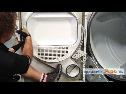

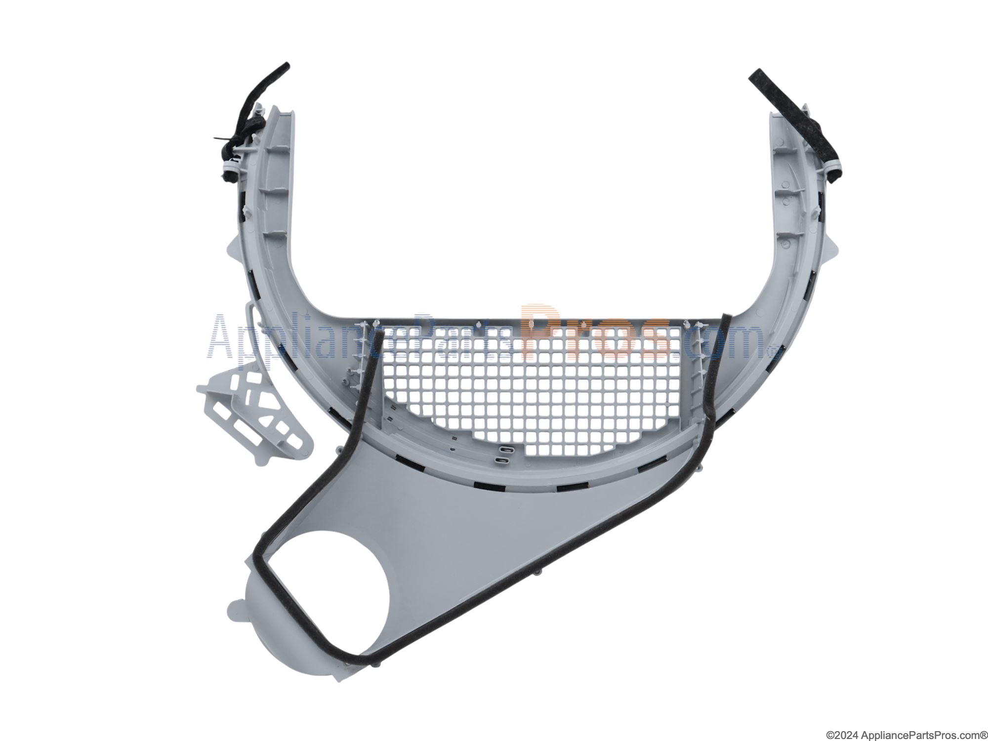

Jim S Horseheads , NY September 21, 2018 Appliance: General Electric Electric Dryer DBXR463EB0WW Sig other had continued to operate dryer until it ate through the side of the cabinet and into the front door (destroying all the plastic parts in the process) Replaced front panel and inner liner of door (kit), trap duct assembly, both bearing slides (gray and white), and drum front support bearing. Procedure is pretty much what one sees in the video clips. Exceptions in our case included: 1. The fact that our door latch¹ was on the front panel while the door strike² was on the door. The newer (replacement) design has the latch on the door and the strike on the front panel! 2. The new door did NOT have the door latch installed (as shown in the photo). Luckily, the latch from our old front panel fit just fine in the new door. Lesson: hang on to all the old parts until the job is done in case you need to salvage some of the old parts for re-use. 3. The foam packaging protecting the lower end of the Trap Duct Assembly was tangled in the adhesive of the round foam gasket. This gasket is critical to the proper operation of the dryer. Be very careful removing the foam packaging or the gasket will require replacement. 4. The upper right hand corner of the new front panel: the crimp holding the corner together was malformed and the crimp had failed; no, these corners were not welded. Fortunately it did not prevent us from installing the front panel in the normal way. 5. Assembly Hint: Before attaching the new front panel to the dryer body, run the two screws that hold it to the dryer body through their respective holes so the threads are already formed. Then when you actually assemble the new front panel to the dryer body, you aren't trying to thread new holes at the same time you are holding the drum, lining up tabs and slots, and putting in the screws. Our old dryer had phillips head screws while newer designs appear to use hex head screws. The latter is better IMHO in case you want to bother replacing them now (because they have to be removed every time you want to replace the Bearing Slides). 6. Speaking of Bearing Slides. There are two DIFFERENT Bearing Sides in use here. The dark gray pair go in the two top positions on the drum front support bearing, while the white pair occupy the the other two positions. Bearing Slides should be checked every 6 to 12 months (more often if dryer used more often) and all four replaced when any of them are damaged or worn to less than 1/4 thickness (about 1/64 inch [0.016 inch or 0.4 mm]). Note, the replacement Trap Duct Assembly includes the two moisture sensing strips. But some dryers do not have this feature so don't fret if you find no wires to connect to the two pins on the strips. _________________________ ¹ Part Diagram #327 ² Part Diagram #3049 Read More... 12 People found this story helpful Do-It-Yourself Rating: Repair Time Estimate: 30-60 minutes Tools: Screwdrivers

John G Reynoldsville , PA November 12, 2014 Bearing slides wore down into the bearing drum support and air duct assembly Replaced air duct assembly, drum support, bearing slides, felt & seal. Read More... 19 People found this story helpful Do-It-Yourself Rating: Repair Time Estimate: 15-30 minutes Tools: Screwdrivers
Dan S Frederick , CO February 06, 2016 Squeaking dryer drum The drum on my GE dryer was producing a horrible squeal. I did some research on the forums and discovered that because the sound seemed to be coming from the top front of the machine, it was likely caused by worn drum glides. I followed the video instructions and opened the dryer up, and very quickly confirmed that two glides were missing, the plastic shield was broken in several places, and the lower shield had been broken from the unbalanced drum. I bought everything I need here, and the parts were delivered about eight hours earlier than I expected. 30 minutes later, the dryer was fixed, and now it's running more efficiently because all the trapped lint is gone. Appliance Parts Pros made my repair really easy! Read More... 13 People found this story helpful Do-It-Yourself Rating: Repair Time Estimate: Less than 15 minutes Tools: Screwdrivers
Phillip C Granite City , IL November 04, 2021 Broken lint chute assembly clothes were getting snagged on it I would never have attempted to do it myself if it weren't for your repair video. I watched it a couple of times then decided to go for it. So I ordered the part on Friday and received it on Sunday. Wow! I couldn't believe that it was here already. I watched the video another time and went to work on it. All went well and I'm extremely pleased. Also, it gave me great satisfaction to have done the job myself, and it saved me the cost of hiring a repairman. Read More... 3 People found this story helpful Do-It-Yourself Rating: Repair Time Estimate: 30-60 minutes Tools: Screwdrivers
