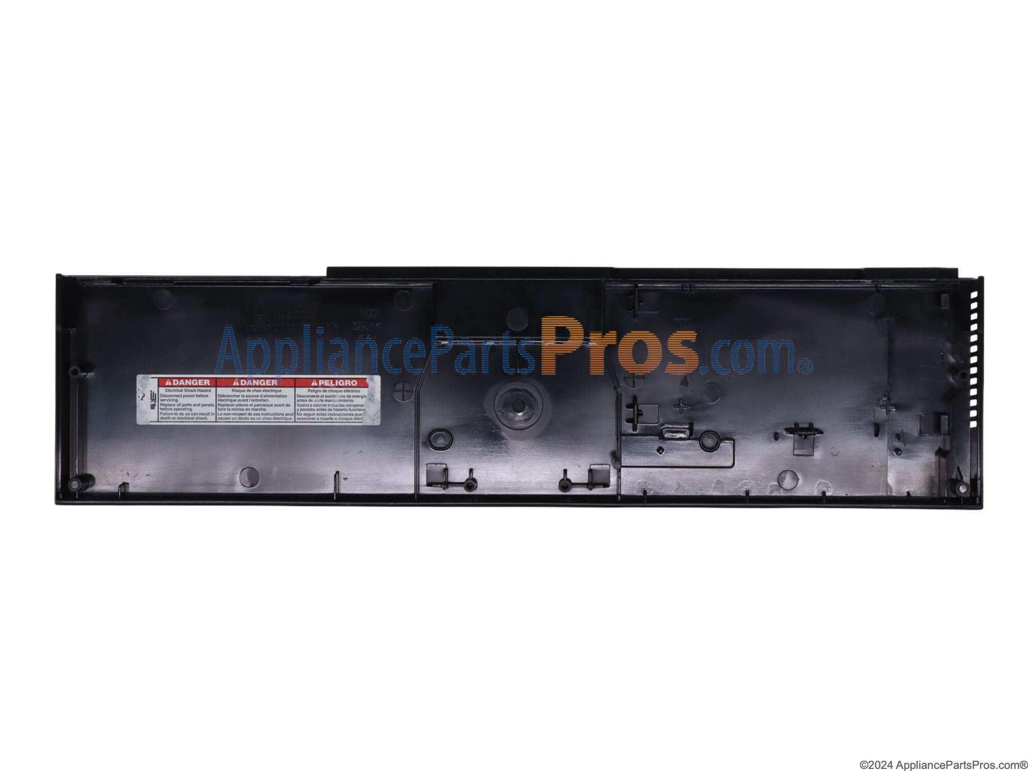

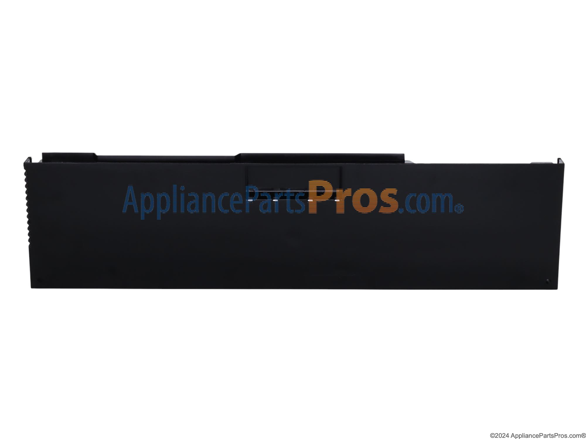

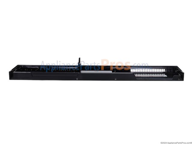

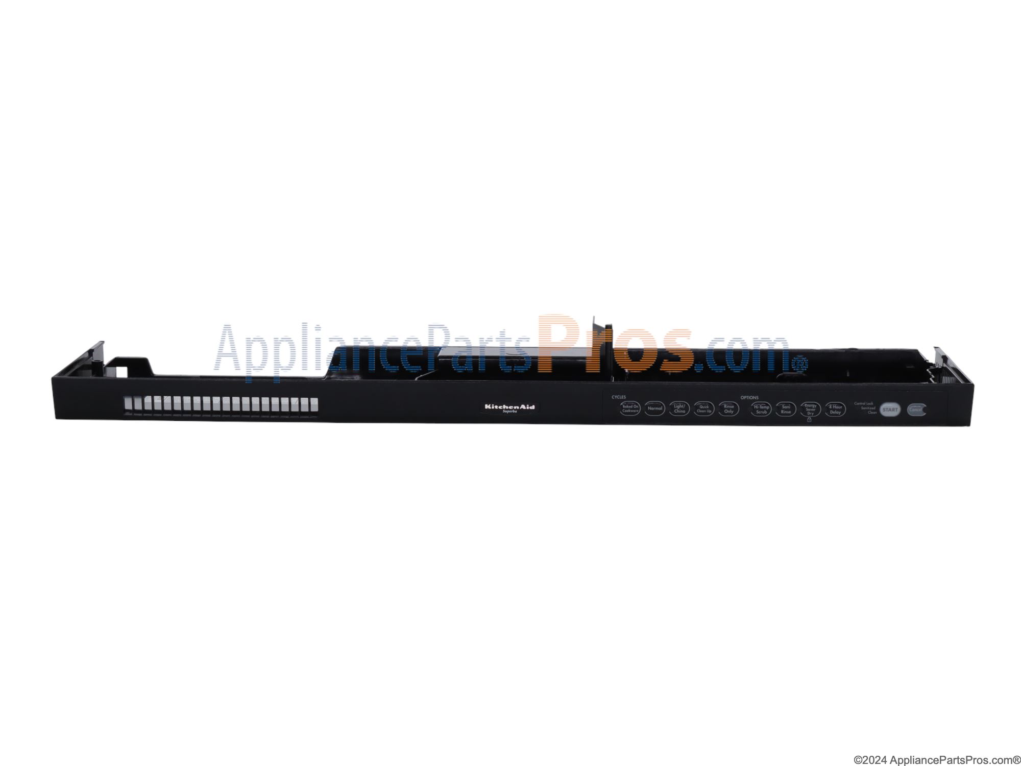

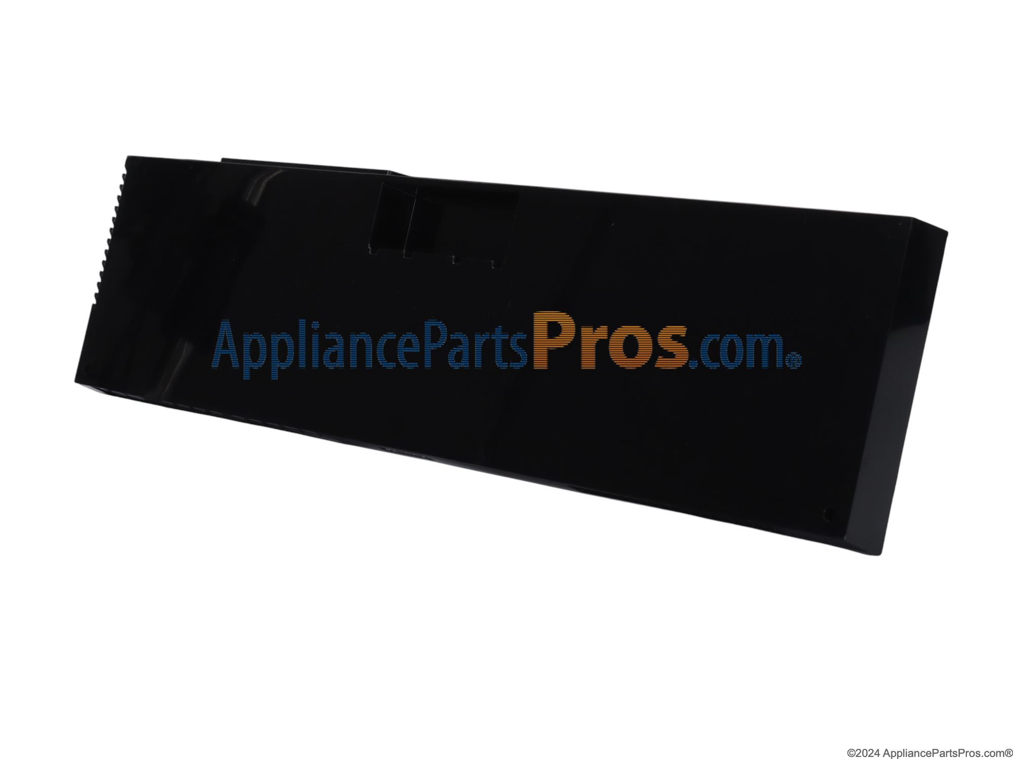

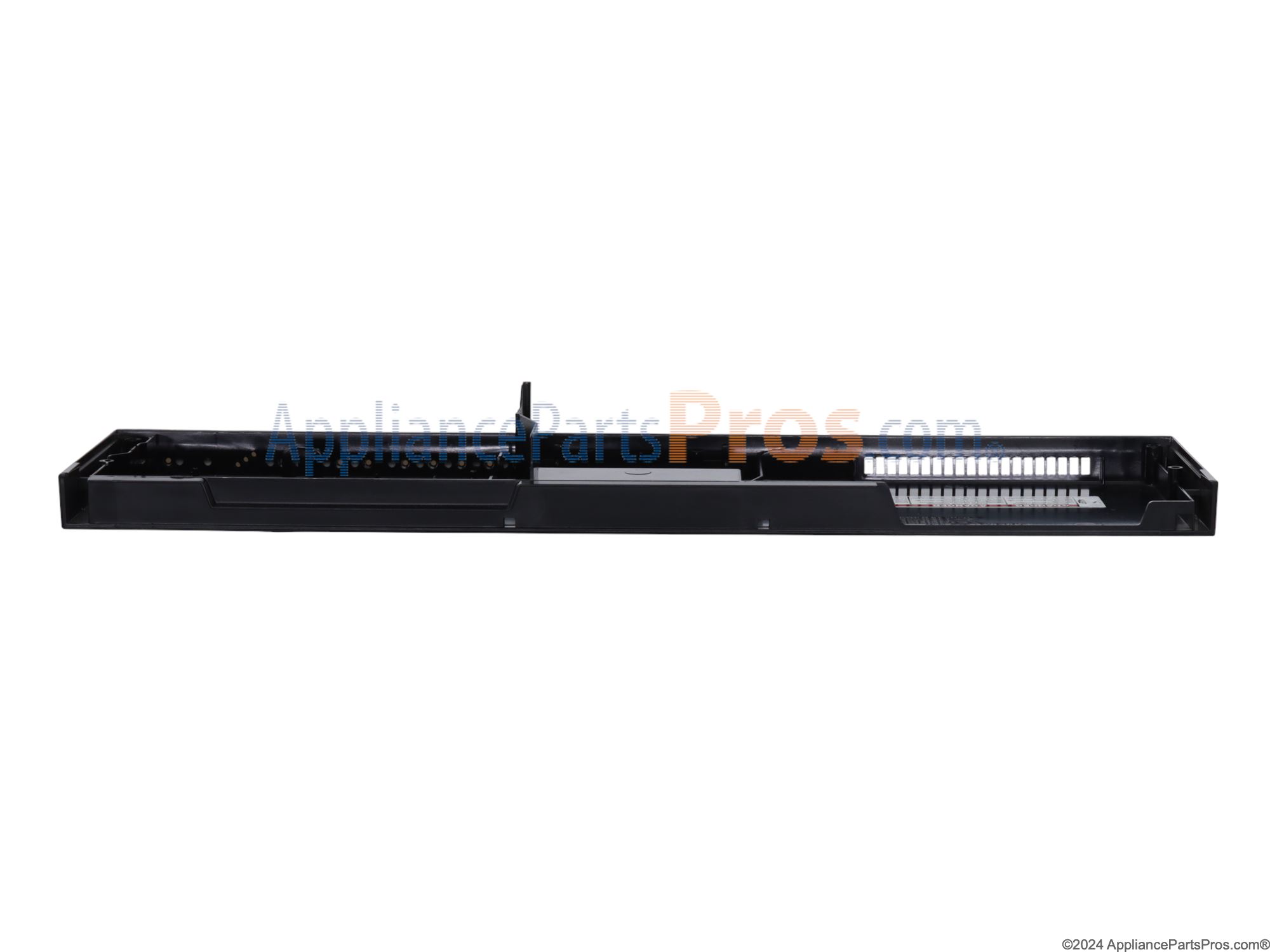

Michael G Treasure Island , FL September 22, 2014 Cracked start button on control panel door balance kit Removed torx screws attaching stainless liner to outer stainless door. Lift off inner door and carefully separate the electronic components from where they snap into the control panel. Relocate electronic components to the new control panel. Reattach the inner liner with the torx screws. It is helpful to have an extra set of hands to hold the control panel while making the electronics swap to avoid pulling on the wiring harness. For door balance kit I just followed the video, straight forward. Read More... 9 People found this story helpful Do-It-Yourself Rating: Repair Time Estimate: 15-30 minutes Tools: Nut Drivers, Pliers, Screwdrivers
Peter B Sunset Beach , NC September 23, 2017 Appliance: KitchenAid Undercounter Dishwasher KUDS01FLSS6 Lights on the dishwasher buttons would not stop blinking and it would not run After chatting with your Customer Service people, I bought the Control Panel because the button covers had worn through and the User Interface board that actually contained the control buttons. I replaced both and the washer works great. The videos were helpful, but were not of the same model as mine, so I went slowly when taking the door apart. Replacing the 2 parts was very easy. Read More... 8 People found this story helpful Do-It-Yourself Rating: Repair Time Estimate: 15-30 minutes Tools: Screwdrivers
Thomas A Falls Church , VA November 27, 2018 Appliance: KitchenAid Undercounter Dishwasher KUDS01FLBL6 Start button and toggle switch was broken along with wore out touch pad buttons Looked online for how to replace control board videos for Kitchenaid confirmed the parts order and followed the video instructions. Parts were a perfect match and with a few screws removed and a few clips to remove the boards and replace the the good board the entire fix took less than 15 minutes. Read More... 1 People found this story helpful Do-It-Yourself Rating: Repair Time Estimate: Less than 15 minutes Tools: Screwdrivers
