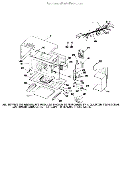

Part Number: WB63T10039
$145.95
Part Number: WB6X538
Part Number: WB6X537
This H.V. bracket secures specific high-voltage or control assemblies to the appliance chassis, keeping components stable and properly aligned so wiring and parts stay protected during normal operation. Durable stamped metal design for reliable support. What it does:
  • Holds and positions high-voltage/control assemblies or related components to the appliance frame
  • Stabilizes wiring and connectors to reduce strain and prevent intermittent electrical contact
  • Helps maintain correct clearance and alignment for safe, consistent operation
  • Can address symptoms like loose components, rattling near the control area, or intermittent electrical connections when the bracket is damaged or missing
  • One H.V. bracket
  • Turn off power to the appliance before attempting any service to avoid risk of shock
  • Install in the original mounting location using the factory screws or hardware; do not force into place
  • Inspect related wires, connectors, and fasteners while replacing the bracket and replace any damaged items
$11.71
Part Number: WB6X535
257
Part Number: WB36X10194
266
Part Number: WB63X10013
$68.65
266A
Part Number: WB63X10016
$34.95
407A
Part Number: WB10X10074
407
Part Number: WB10X10015
413A
Part Number: WB63X10015
$43.48
413
Part Number: WB63X10011
$93.95
413B
Part Number: WB63T10069
$10.73
427
Part Number: WB26X172
Fix a microwave turntable that won't rotate, stalls, or makes grinding noises. This motor spins the glass tray for even heating. DIY repair in 10 minutes.
$84.95
439
Part Number: WB06X10034
443
Part Number: WB24X10034
446
Part Number: WB34T10072
This duct assembly directs airflow from the appliance's blower to the exhaust port, restoring proper venting and helping the unit clear moisture and combustion gases. Designed to match OEM fit and airflow path. What it does:
  • Channels exhaust air from the blower housing to the appliance vent
  • Helps maintain proper airflow for drying, venting, or combustion exhaust
  • Can reduce overheating and poor venting symptoms like long dry times, moisture buildup, or unusual odors when defective
  • Replaces damaged, cracked, or disconnected ducts that cause airflow loss
  • One duct assembly as shown
  • Inspect surrounding seals and fasteners; replace any damaged clips or gaskets for a secure fit
  • Disconnect power to the appliance before starting any repair to avoid electric shock
  • Handle gently to avoid bending or cracking the duct; align and secure all mounting tabs per OEM guidance
  • Verify external venting is clear after installation
$63.23
461
Part Number: WB63X10012
463A
Part Number: WB27X10166
463
Part Number: WB6X549
463B
Part Number: WB24X10025
466A
Part Number: WB14X10008
466
Part Number: WB10X10017
480
Part Number: WB27X1170
This is a humidity sensor mounted inside the microwave that detects moisture levels in the cooking cavity. It enables auto-cook and auto-reheat functions by signaling the control board when food has released enough steam. Replace this sensor if auto-cook cycles consistently overcook or undercook food, or if the microwave displays a sensor error code.
$101.46
511
Part Number: WB26X10026
522
Part Number: WB35X10001
$11.38
531
Part Number: WB35X10002
$11.00
556
4.9 (76)
Part Number: WB24X830
This is a monitor or interlock switch that detects whether the microwave door is properly closed before allowing the unit to operate. It is a safety device that shuts off microwave power if the door is open or if other door switches malfunction. Replace this switch if the microwave does not start, runs with the door open, or blows a fuse when the door is closed.
$38.95
562
4.9 (60)
Part Number: WB27X10928
The Fuse is an OEM part for GE microwaves. It serves as a safety device designed to protect the microwave from excessive current that can cause overheating and potential fire hazards. When the current flowing through the microwave circuit exceeds a certain level, the fuse blows or breaks, cutting off the power to prevent damage or fire.
Common causes for a fuse to blow include power surges, faulty wiring within the appliance, or the use of microwave inappropriate containers that cause sparks. It is essential to address these issues not only to replace the fuse but also to correct the underlying problems to prevent future failures.
Symptoms of a bad fuse include:
  • The microwave suddenly stops working.
  • No signs of power or response even when the microwave door is closed and the start button is pressed.
576
4.9 (158)
Part Number: WB24X829
The Microwave Door Switch is an OEM part for GE microwaves, designed to prevent the microwave from operating when the door is open by interrupting the power whenever the door is not securely closed. The door switch is an essential safety feature.
Symptoms of a failing Microwave Door Switch include:
  • The microwave not starting or heating
  • Running when the door is opened
  • Unusual noises when the door is closed
Causes of a bad Microwave Door Switch can result from repeated opening and closing of the door or slamming that can cause the switch to degrade or become misaligned, leading to intermittent or failure.
578
Part Number: WB27X10073
This microwave high-voltage capacitor stores and releases energy in the high-voltage circuit to power the magnetron. Replacing a failed capacitor helps restore proper heating and protects other components in the high-voltage system.
  • Works with the transformer and high-voltage diode to supply the magnetron with the required voltage
  • Failure may result in the unit running but not heating
  • Shorted capacitors can blow the internal fuse or trip a breaker; opens may cause loud humming or buzzing
  • Visible swelling or leakage on the capacitor body are common failure signs
What's included: One high-voltage capacitor Install notes:
  • Unplug the microwave; capacitors can retain a dangerous charge even when unplugged—discharge using an appropriate, insulated method before servicing
  • Note wire positions and terminal orientation; transfer any mounting hardware from the original part
  • Mount securely and route wires to avoid pinching
$98.53
579
4.8 (11)
Part Number: WB27X10516
Microwave not heating but runs? Replace the magnetron to restore cooking power. Intermediate DIY repair taking 1-2 hours with proper safety steps.
$282.36
582
Part Number: WB27X10189
This high-voltage transformer steps up household current to power your microwave's magnetron tube. It converts standard household voltage to the high voltage needed to generate microwaves for cooking. Replace this transformer if your microwave doesn't heat food, makes loud humming noises, or repeatedly blows fuses.
597
4.8 (25)
Part Number: WB27X10597
Microwave not heating but lights and timer work? The high voltage diode converts AC to DC for the magnetron. DIY repair in 1-2 hours with basic tools.
$55.53
999
Part Number: WB18T10275
