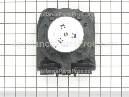

Curtis July 25, 2019 for Model Number 11028832700 Hi, the washer will fill with water and stop. The cycle knob will continue to the end. If I turn the knob back a little it will drain, spin, and finish like normal. Is this a timer issue?
1 Answer Hello Curtis,yes that is a timer issue, part 280223, is the timer for your model. Read More...

Jack B. January 07, 2015 for Model Number 11028832700 Tub fills with water and starts to wash after a few minute or so it drains the water. It dose not matter what size load. I was thinking timer . Looking for your expert advice . Thanks
1 Answer Jack, If the timer is advancing to the point where it is supposed to drain and spin in just a few minutes then the issue would be in the timer 280223. Read More...
