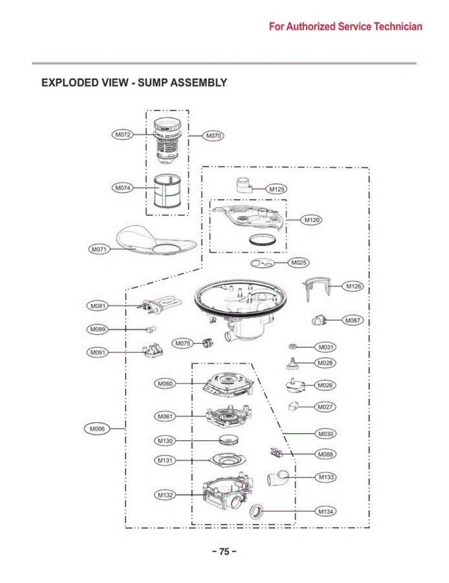

The Diverter Motor Assembly is an OEM part for LG dishwashers. It is a critical component used to control the direction of water flow within the dishwasher, ensuring that water is properly diverted between the different spray arms during various wash cycles.
Symptoms of a failing Diverter Motor Assembly include:
  • Inadequate cleaning of dishes, with some areas remaining dirty
  • Unusual noises, like humming or clicking, indicating the diverter motor is struggling to operate
  • Error codes displayed on the dishwasher that relate to water distribution problems
  • Water not reaching all spray arms
Causes of a bad diverter motor can include wear and tear from regular use, electrical issues such as faulty wiring or motor failure, and mechanical obstructions or debris that prevent the diverter from moving smoothly.
This OEM LG part is also compatible with Sears/Kenmore models.

The Micro Switch is an OEM part for LG dishwashers. It plays a crucial role in detecting when the door is securely closed prior to starting a cycle. This important safety feature prevents accidental exposure to hot water, detergent, and chemicals.
Causes of a bad micro switch include degradation from years of repeated use, debris interfering with mechanisms, or damage from attempts to force or slam the dishwasher door closed.
Symptoms of a bad micro switch include:
  • Cycles failing to start despite a closed door
  • Hot water or steam visible escaping when running
  • The dishwasher not detecting the closed door position
  • Error codes displayed related to door position sensors
This OEM LG part is also compatible with Sears/Kenmore. Replacing only when truly faulty helps ensure safe and reliable dishwasher function.

Loud droning noise during cycles? A cracked pump casing causes leaks and poor water flow. Moderate DIY repair requires dishwasher removal and reinstall.

Seals the cam motor shaft to prevent water leaking into motor and electrical components. Replace if you notice leaks around the motor area or water damage.

Fixes noisy wash cycles and dishes that won't come clean. This motor drives water through spray arms. DIY install takes 90 minutes with basic tools.

Screens debris to protect components and maintain cleaning performance. Replace if torn, warped, or clogged to restore water flow. Confirm fit with model.

Fix incomplete draining and pulsing sounds during drain cycles. This dishwasher check valve prevents backflow. Easy 30-minute DIY repair.

Fix HE or tE error codes and dishes not drying properly. This dishwasher heating element assembly heats water for washing and drying. Moderate DIY.

Joins dishwasher hoses to ports for leak-resistant connections. Replace this small connector if it's cracked, split, or loose to stop drips at the joint.

Fixes poor spray or weak water circulation in your dishwasher. This impeller assembly restores proper water flow. Moderate DIY repair, 30-45 minutes.

This is the lower case housing for the dishwasher's circulation pump assembly. It encloses and supports the pump motor that recirculates water through the spray arms during wash and rinse cycles. Replace this housing if it is cracked, warped, or leaking water beneath the dishwasher during operation.
