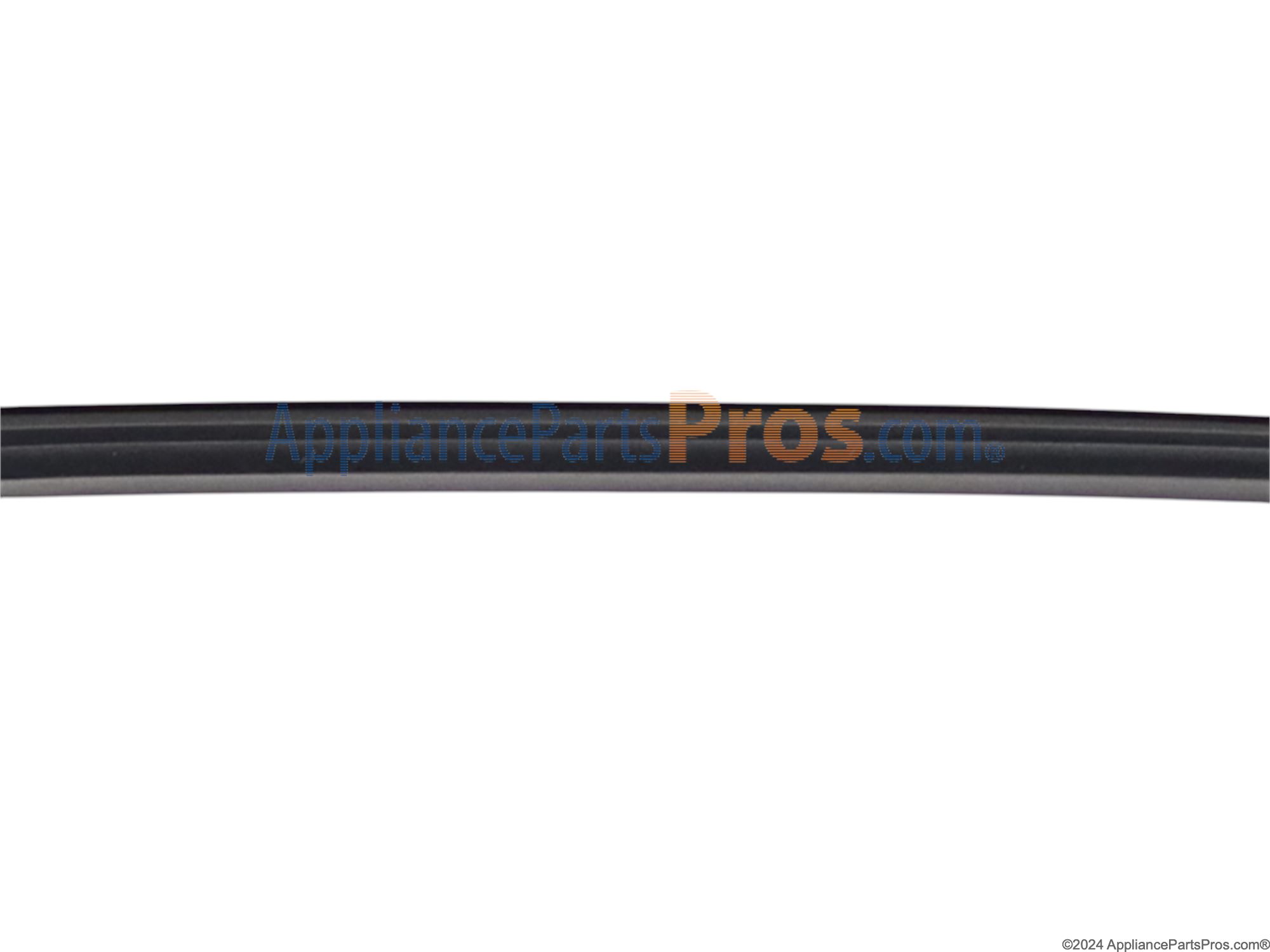

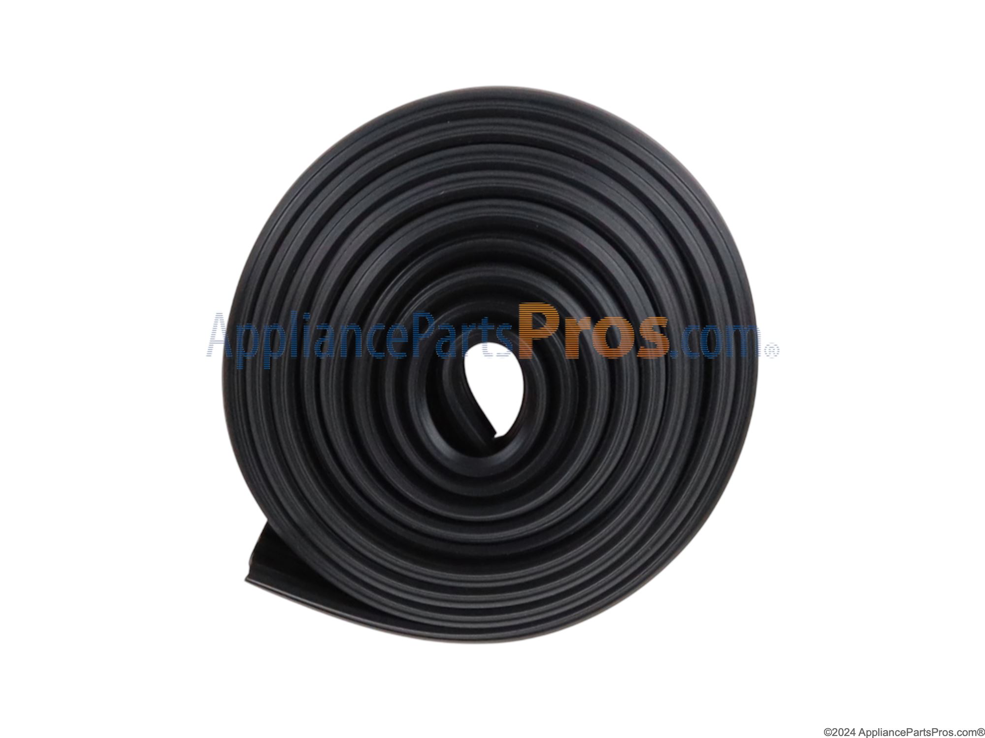

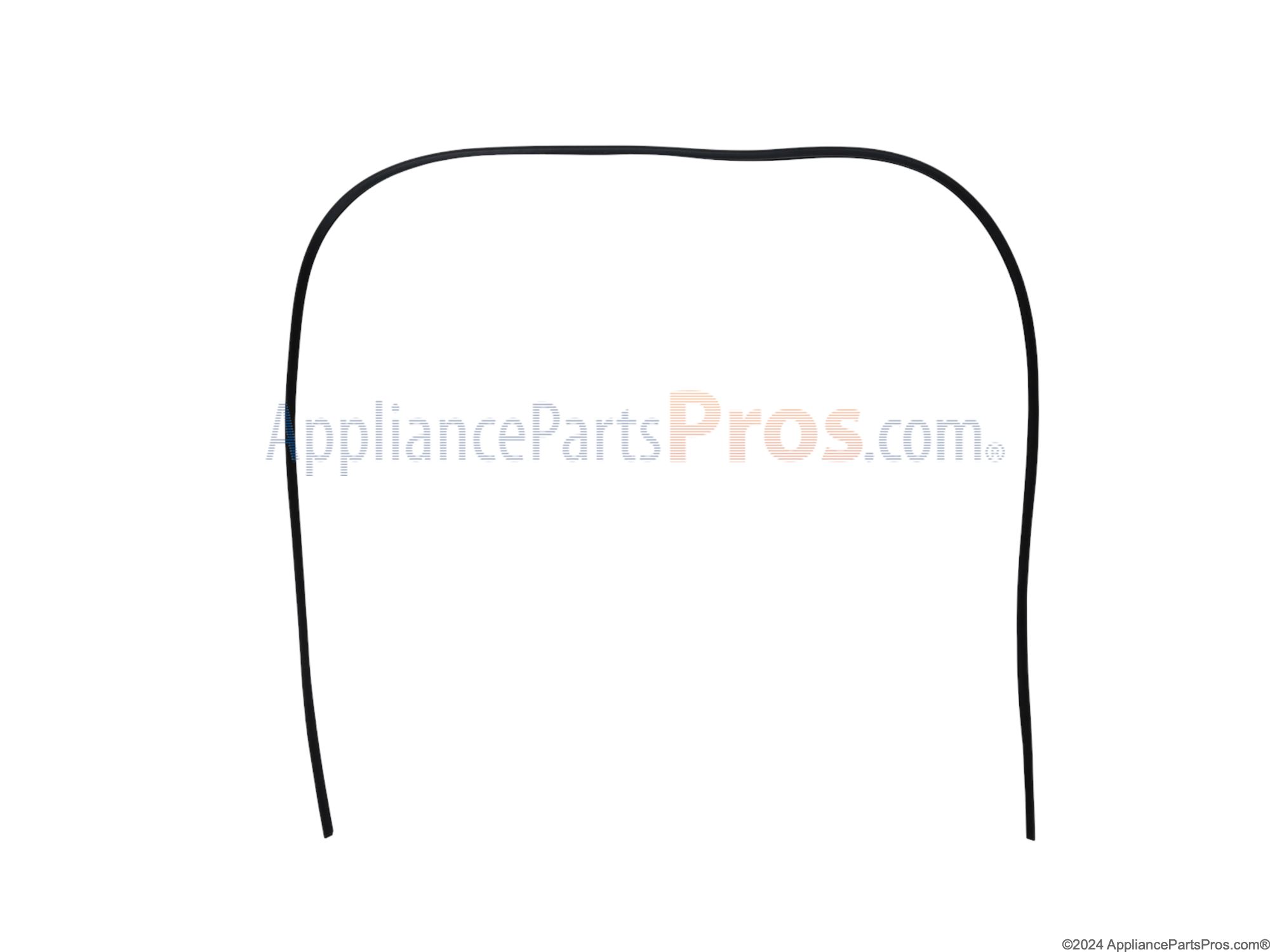

Antun K San Francisco , CA December 10, 2015 Appliance: Whirlpool Undercounter Dishwasher WDT910SAYM1 Leaking water from bottom left of door I replaced the door seal, and that fixed the leak. Took about 5 minutes to do. Before ordering the seal, I had tried cleaning the seal with a sponge, leveling the dishwasher using the screws at its feet, and tightening all the torx screws around the door. None of those had fixed it; the seal was just bad. Read More... 59 People found this story helpful Do-It-Yourself Rating: Repair Time Estimate: Less than 15 minutes
Heidi S Murrieta , CA July 17, 2014 Appliance: Model KENMORE 665.13293K110 Dishwasher leaked from door Replaced gasket that runs along to and side edges of dishwasher (not on the door itself) Read More... 16 People found this story helpful Do-It-Yourself Rating: Repair Time Estimate: 15-30 minutes

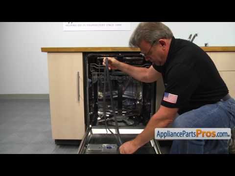

Terry W Buena Vista , CO September 20, 2015 Leak fom the left front corner of the dish washer I bought a seal from APP. It arrived in an unbelievably short time. I watched a video on the replacement and it was done with no stress and in a short time. So glad for APP! Read More... 7 People found this story helpful Do-It-Yourself Rating: Repair Time Estimate: Less than 15 minutes
