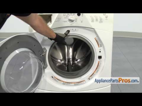

Sheila F Niles , MI March 29, 2017 Appliance: Maytag Washer MHWE301YW00 Suspension spring broke and washer drum snapped a shock in half as it dropped. We ordered the parts and watched the videos provided by Appliance Parts Pros and did the repair ourselves. Local repair co gave us an estimate of $500 to do the very same repair. By doing the repair ourselves we saved more than $350. We replaced all 3 shocks and both springs. The shocks were harder to remove than the video led you to believe, the tabs did not release for us as easily as in the video, but we eventually got them with some force. I was so thrilled to be able to repair the machine ourselves as it is only 5 years old. Read More... 3 People found this story helpful Do-It-Yourself Rating: Repair Time Estimate: 2+ hours Tools: Nut Drivers, Pliers, Screwdrivers

Lawrence C Blue Springs , MO August 06, 2017 Washer gets off balance and walks Found most common parts needed . Ordered parts, installed, works like new. Website was easy.Entered model number, located parts on diagram, ordered parts, received 2 days later. Also had video on how to install, great help! Read More... 1 People found this story helpful Do-It-Yourself Rating: Repair Time Estimate: 30-60 minutes Tools: Nut Drivers, Socket Set, Wrench Set
