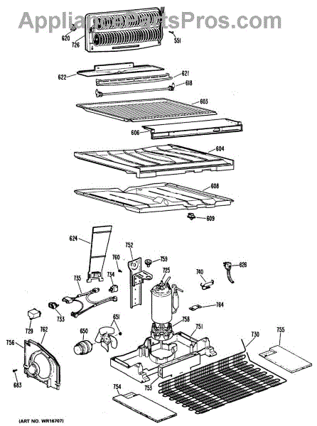

Parts for Ge CTX18EKBR: 03 - Section3 Parts
603
$113.32
$116.07
$2.75
604
606
608
608
609
4.9 (93)
The Light Switch is an OEM replacement part for GE refrigerators. It controls the interior light, turning it on when the refrigerator door is opened and off when the door is closed. This ensures proper illumination for visibility when accessing the refrigerator's contents.
A malfunctioning light switch can result from wear and tear, electrical issues, or damage caused by repeated use. Over time, the internal mechanism may fail, or the housing can crack, leading to improper operation.
Symptoms of a bad light switch include:
  • Interior light not turning on when the door is opened
  • Light staying on even when the door is closed
  • Flickering or inconsistent light operation
  • Difficulty pressing or releasing the switch
$19.03
$20.93
$1.90
618
4.6 (7)
This defrost heater kit warms the evaporator during the automatic defrost cycle to melt frost and keep air moving. Replace it when ice builds up on the freezer coils and temperatures rise or airflow is restricted.
  • Heats the evaporator coil during defrost to clear accumulated frost/ice
  • Helps maintain proper airflow and stable temperatures in both compartments
  • Symptoms can include heavy frost on the back wall/evaporator cover, reduced cooling, or fan noise from ice contact
  • A failed heater can leave the defrost system unable to clear ice, restricting airflow
What's included: 1 defrost heater kit Install notes:
  • Access the heater behind the freezer's rear panel; safely remove heavy ice before replacement
  • Move wires and clips one at a time, routing exactly like the original to avoid pinched or exposed conductors
  • After replacement, monitor defrost operation; icing persists, also check the defrost thermostat and control
$117.23
$140.68
$23.45
620
4.9 (8)
Open - 60, close - 40
$11.70
$30.42
$18.72
621
622
622
624
626
This cable clamp secures refrigerator wiring to the cabinet, keeping harnesses organized and protected. Replacing a missing or damaged clamp helps prevent chafing and vibration noise while maintaining proper clearance from fans and other moving components.
  • Anchors wire harnesses in their designed routing
  • Helps prevent insulation wear from rubbing or vibration
  • Keeps wires clear of sharp edges and moving parts
  • Common signs it's needed: missing/broken clamp, loose or dangling wires, or new rattling/buzzing noises
What's included: 1 cable clamp Install notes:
  • Access the clamp location and note original wire routing
  • Position the clamp and secure with the existing fastener; do not overtighten
  • Ensure wires aren't pinched and have clearance from the fan/compressor before restoring power
$7.37
626
This power cord assembly supplies electrical power from the wall outlet to your refrigerator. Replace a cut, frayed, or overheated cord to restore safe, reliable operation and eliminate intermittent power loss caused by a damaged cord. What it does:
  • Provides the electrical connection between the household outlet and the refrigerator's wiring
  • Helps resolve no-power or intermittent power when the cord is moved
  • Addresses visible damage such as cuts, cracks, fraying, or a melted/discolored plug
  • Mitigates arcing, sparking, or a burning odor originating from the cord or plug area
  • One power cord assembly
  • Disconnect power by unplugging the unit or switching off the circuit breaker before servicing
  • Pull the refrigerator forward for access; note the original cord routing and connections
  • Install the new cord along the same path and secure any built-in strain relief; ensure the ground connection is properly seated
  • Restore power and verify operation
$22.35
$26.82
$4.47
650
5.0 (35)
The Condenser Fan Motor is an OEM part for GE refrigerators. It is designed to circulate air through the condenser coils, helping to dissipate heat and keep the refrigerator's internal components cool. This ensures efficient operation and prevents the compressor from overheating, which is essential for maintaining the refrigerator's performance and longevity.
You should replace the condenser fan motor if it becomes faulty. Causes of a bad fan motor can include electrical failures, wear and tear from regular use, or blockages that cause the motor to overheat or burn out. A malfunctioning fan motor can lead to inadequate cooling, increased energy consumption, and potential damage to other refrigerator components.
Symptoms of a bad condenser fan motor include:
  • The refrigerator not cooling properly
  • Unusual noises coming from the back of the refrigerator
  • The compressor running hot or cycling on and off frequently
  • The condenser coils feeling excessively hot
$226.48
$269.51
$43.03
651
651
651
683
725
726
726
729
A replacement motor start/run capacitor that helps restore reliable motor starting and smooth operation for compressors and fans. Installing the correct capacitor can reduce hard-starts, humming and intermittent motor operation. What it does:
  • Provides the temporary boost motors need to start and stabilize while running.
  • Helps compressors and fan motors start more easily and run more efficiently.
  • Commonly associated with symptoms like humming, motors that won't start, intermittent operation, or reduced cooling performance.
  • Prevents repeated motor stress that can lead to overload trips or premature motor wear.
What's included: One capacitor Install notes:
  • Disconnect power to the appliance before accessing electrical components.
  • Discharge the capacitor and tag/photograph wire locations before removal to ensure correct reinstallation.
  • Replace with the exact OEM part or an approved equivalent; do not bend or puncture the capacitor can.
$75.40
$90.95
$15.55
730
733
734
$12.61
$13.87
$1.26
735
740
  • Reduced cooling efficiency
$57.22
$68.66
$11.44
751
752
$44.95
$52.79
$7.84
753
754
755
756
758
$40.56
$18.61
759
$11.61
$23.06
$11.45
762
764
