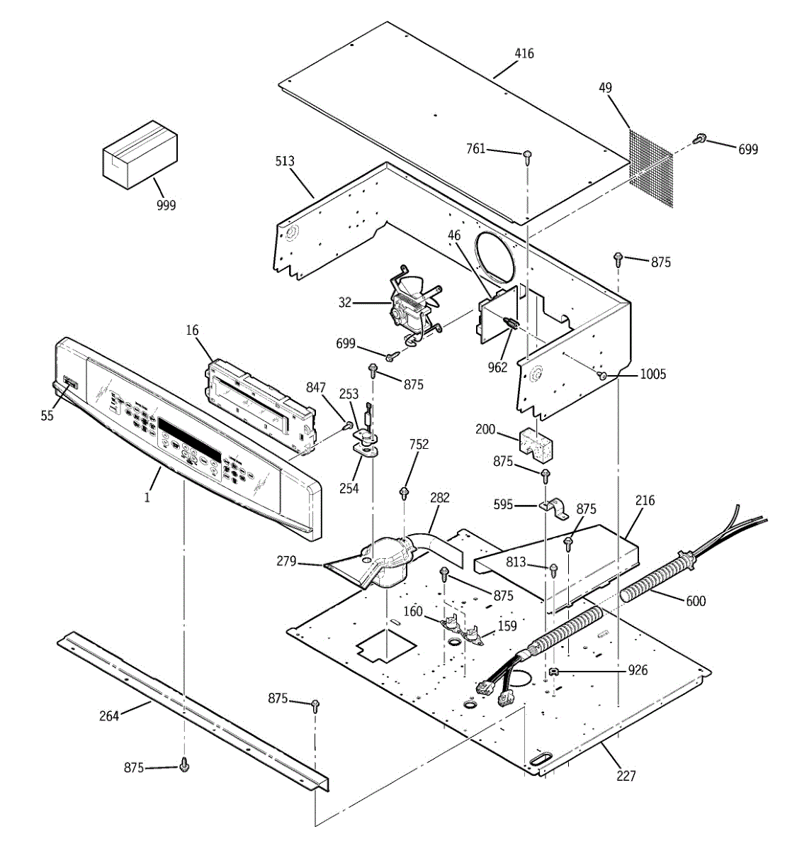

This control cooling fan assembly circulates air through the oven's control compartment to remove heat. By keeping the console and electronics cool during and after cooking, it helps prevent overheating and protects sensitive components.
  • Moves air across the control area to dissipate heat from the board, wiring, and trim
  • Runs during/after bake or broil to maintain safe cabinet temperatures
  • Typical failure signs: fan doesn't run, loud vibration/squeal, control area feels very hot, or heat-related shutdowns
  • Purpose-built for the control compartment; distinct from the convection fan inside the oven cavity
What's included: 1 control cooling fan assembly Install notes:
  • Disconnect power at the breaker and allow the appliance to cool; wear cut-resistant gloves
  • Access is typically from the rear or top; remove panels/guards per your model's service information
  • Transfer any required brackets or ducts; secure so the wheel spins freely with no rubbing
  • Reconnect wiring as originally routed, keeping harnesses clear of the blade; test operation before reassembly

Fix a blank display, unresponsive buttons, or oven not heating with this electronic control board. Controls bake/broil cycles and timing functions.
Part Number: WB34T10091
Cooling fan screen filter for ovens and wall ovens. Replace if clogged with debris or damaged to maintain proper airflow. Verify fit with your model.
$39.21

Oven won't heat or shuts off during baking? A faulty thermal fuse cuts power when detecting excessive heat. This safety device protects your range.

Oven overheating or showing error codes? This limit thermostat cuts power when temperature exceeds safe limits. Common fix for F9 errors and overheat issues.

Protective cover that shields wiring at the top of your oven. Replace if cracked, broken, or missing to protect electrical connections and components.

Fix F2 or F3 error codes with a new oven temperature sensor. Restores accurate heating when your oven shuts off or won't maintain temperature. 10-15 min DIY.

Black interior vent trim for wall ovens. Replaces cracked, discolored, or missing trim pieces around the interior vent opening. Cosmetic component.

Oven vent box assembly that routes hot air and steam from the cooking cavity. Replace if cracked, damaged, or missing to restore proper ventilation.

Vent tube for electric ranges and ovens. Connects oven cavity to exhaust system. Replace if cracked, broken, or missing to restore proper ventilation.

Replace your oven's fan housing cover if it's cracked, broken, or missing. This protective cover installs over the cooling fan assembly to ensure proper airflow.

Protective housing cover for oven fan assembly. Installs over fan motor to shield internal components. Replace if cracked, broken, or missing.

Replacement screw for securing oven components, panels, and brackets. Restores tight mounting when original screws are missing, stripped, or lost.

Circuit board standoff for ovens. Mounts between the control board and housing to provide proper spacing. Replace if broken, cracked, or missing.

Wire harness connecting the logic board to the display panel in wall ovens. Replace if wires are frayed, connectors are damaged, or harness is broken.
