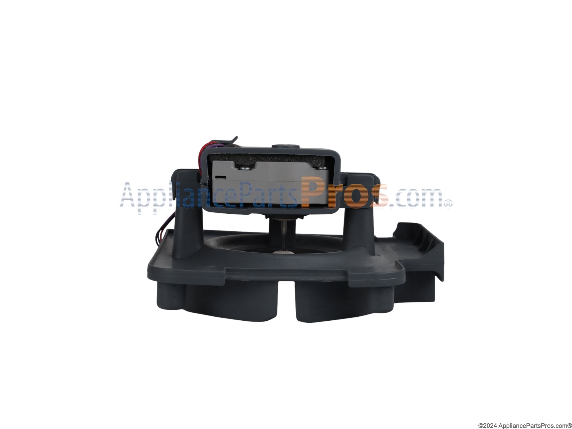

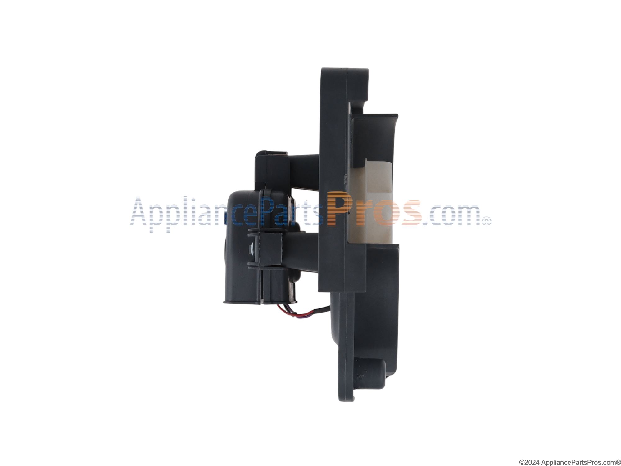

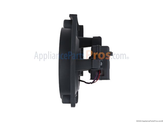

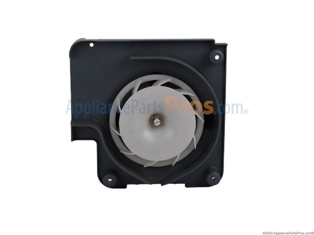

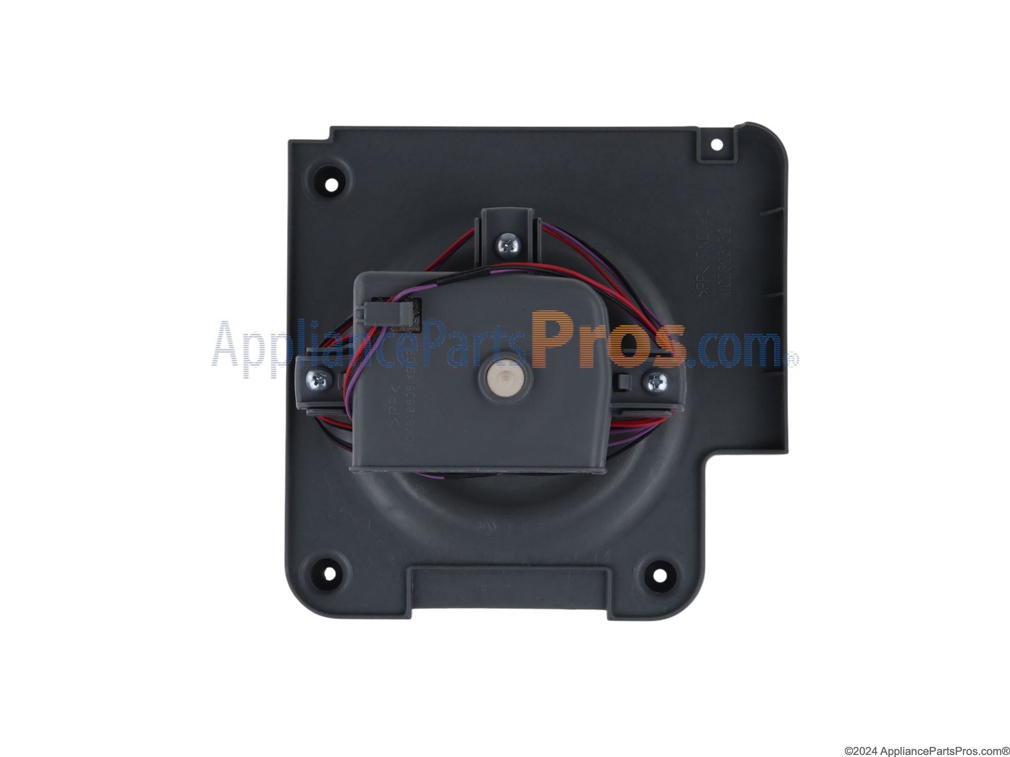

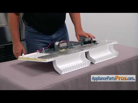

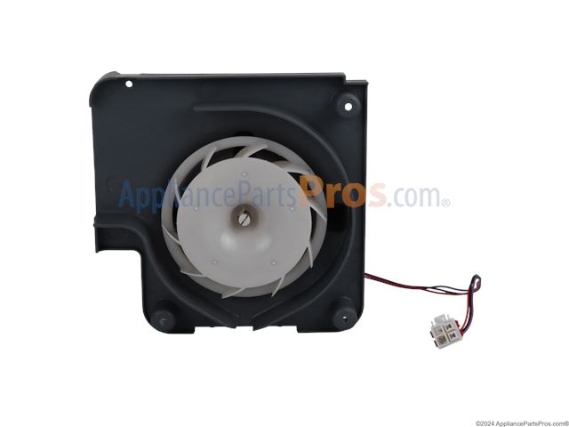

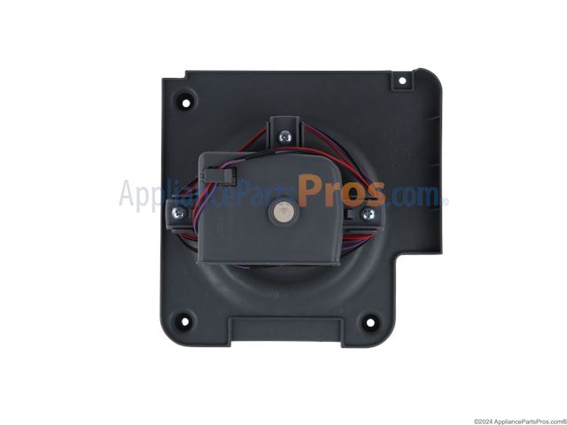

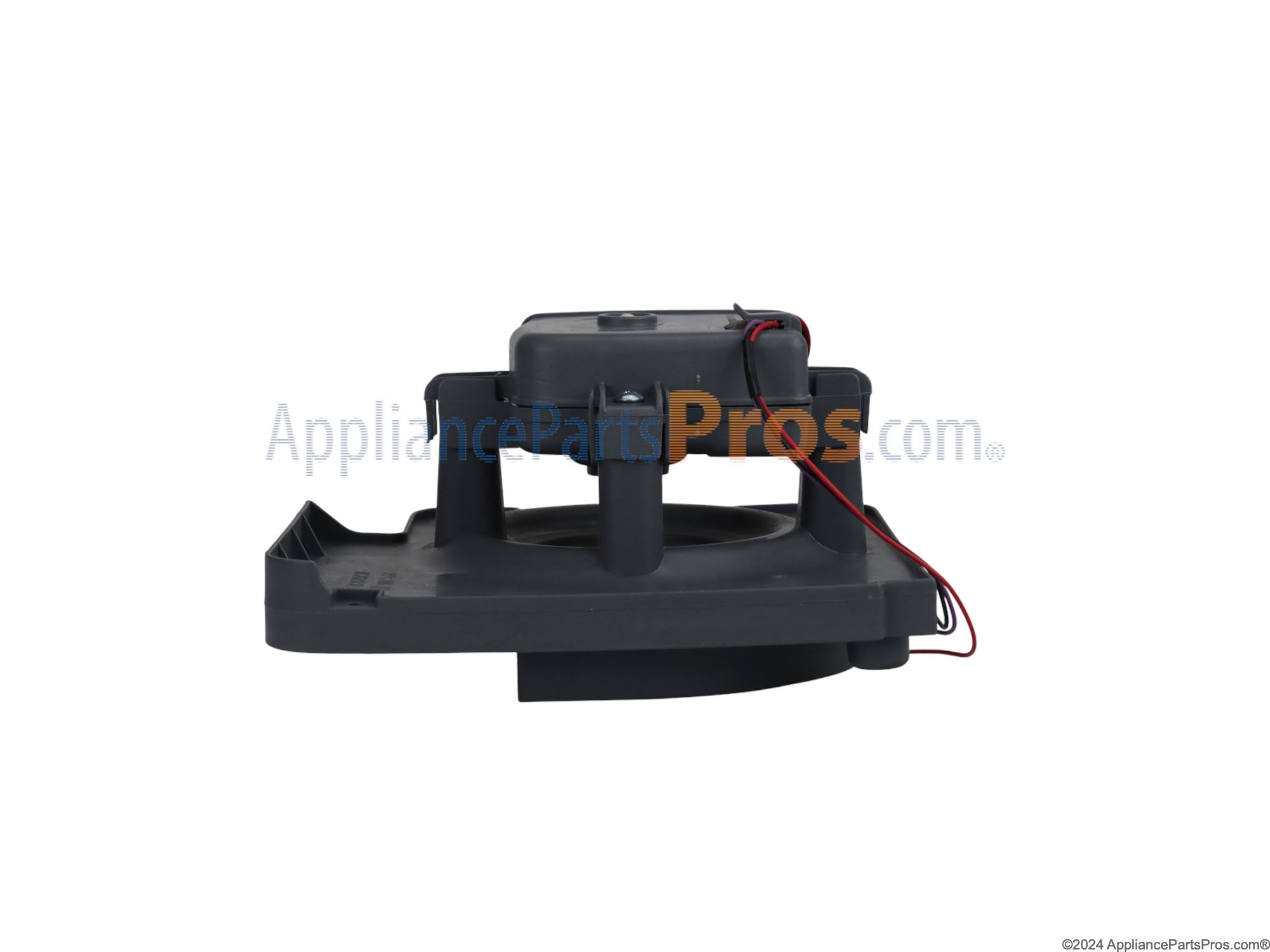

Thomas W Manassas , VA March 18, 2019 Appliance: Model LFX33975ST (02) LG er 1f error code (ice maker fan) I only needed the Bracket Assembly motor, not the DC Motor or Fan Assembly that I also ordered so I will be sending those back. The repair was extremely straightforward with a few bumps along the way. All told it took me about an hour. I started with shutting off the breaker for the refrigerator and putting all of the frozen food in coolers. Then I removed the drawers and the bracket for the drawer rails on the left side (as your facing the refrigerator). I then proceeded to gently pry off the back panel of the freezer, starting at the upper left corner. It was completely frozen in place so this took a little time. When I was able to partially pull the panel off I saw that it was chunk of ice frozen to the ice maker fan insulation and the wire bundle going to the coils. Once I melted all of that the panel lifted right out after removing the 3 wire connectors in the upper right of the back of the freezer. I then removed the four screws holding the fan in place and some electrical tape holding wires together. Used the same screws to put the new fan in place, and a re-ran and taped the wires. I reinstalled the back panel starting at the bottom and working my way around the bottom left clockwise. Pretty simple work and saved a $100 visit fee. Read More... 69 People found this story helpful Do-It-Yourself Rating: Repair Time Estimate: 30-60 minutes Tools: Screwdrivers
Andy W Dallas , PA September 26, 2014 Ice maker had error f1 Determined that the fan was not working and replaced it with a new fan and motor combination and the error went away. For some reason u have to buy the whole set up not just the motor which was the problem, a little confusing on the schematic for the refrigerator 407a Read More... 14 People found this story helpful Do-It-Yourself Rating: Repair Time Estimate: Less than 15 minutes Tools: Screwdrivers
Robert B Madison , WI October 09, 2019 Appliance: LG Refrigerator LFX31925ST ER FF code on the front of the refrigerator After clearing ice from the freezer fan area (twice) did not solve the problem, we presumed that the freezer fan/motor had stopped functioning. We looked up the parts on AppliancePartsPros website and ordered. The parts arrived within a day and a half. After watching a couple of installation videos, the parts were fairly easily replaced using standard screwdrivers. The freezer now works great! Read More... 14 People found this story helpful Do-It-Yourself Rating: Repair Time Estimate: 30-60 minutes Tools: Screwdrivers
Patrick O Monroe Township , NJ March 22, 2016 Appliance: Model LFX33975ST Loud noise coming from the freezer section (bottom) of my fridge Emptied freezer, took door off rails, removed all drawers, opened and removed sensor in top corner, pulled out back wall of freezer (where fans were) and found the fan that was making the noise. Replaced it and put everything back. Hardest part was actually putting the top drawer back in on the rail. Read More... 12 People found this story helpful Do-It-Yourself Rating: Repair Time Estimate: 30-60 minutes Tools: Screwdrivers
Benjamin R St. Augustine , FL April 28, 2017 Appliance: LG Refrigerator LFX31925SW Ice maker would not freeze water or makes ice test button functioned properly fan suspected This problem was with an LG French Door unit. Trouble shot the problem with one of the AppliancePartsPros and she came to the same conclusion: cold air fan from the freezer inoperable. Everything was done professionally. When the fan arrived (within 48 hours...OUTSTANDING!) I began to unload the freezer to remove the back panel and replace the fan. Then I saw the ICE....LOTS OF ICE over the airflow inlets. Removed the drawers, got the old ladies hair dryer and in 30 minutes I was making ice cubes again. Needed a thorough defrost to fix the system. Now I have a brand new fan if the old one ever wets and bed. Parts Pros are great but my repairs are a live and learn practice. Read More... 3 People found this story helpful Do-It-Yourself Rating: Repair Time Estimate: 30-60 minutes Tools: Screwdrivers
