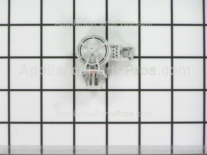

Bradley June 30, 2026 for Model Number w10783951a I purchased the water pressure level switch but I have a top loading washer. I've removed the back of the washer and the back of where the knobs are. The tube for the water pressure goes into the control board and the other end goes into the drum. I cannot find the actual switch anywhere to replace it. Can someone help with where I should be looking?
1 Answer Hello Bradley, thank you for contacting AppliancePartsPros.comIf the pressure hose is going directly to the control board then the sensor is built onto the control board, we would need the model # to identify the correct part. Read More...

Donna Miles May 19, 2024 for Model Number WFW75HEFW0 I've gotten the F9E1 code for the last couple of washes. Is the correct part replacement the pressure sensor switch? What's the item number?
1 Answer Donna, There are a few things you will want to check. First, make sure that the unit is draining. If it is not then check the drain filter to make sure that it is not clogged up. If it is clear then check to ensure that the drain pump is working. If the drain is working then check the pressure hose to make sure that it is not clogged. Check the J17 connector to make sure that the connection is good. Make sure the drain hose is not blocked or kinked. and if this is good then replace pressure switch WPW10448876. Read More...

Jim January 21, 2024 I have a frontload whirlpool washer that started giving me a f01 e03 error code. I blew through the hose from the water level switch and it fixed th problem for about a month and then it started again. I replaced the water level switch #wpw10448876 and that fixed it for almost a year. the weird thing is I have had the error code go off in the middle of the night when no one was using the machine.I cleaned out the air chamber tube and it has again worked for a few loads.. could there be another issue since it goes off in the middleof the night?
1 Answer Jim,This could be an issue with excess suds. You can use a washer cleaner to remove any build-up and cut back on the amount of detergent used. It could also be a board issue giving a false code. Read More...
Brian August 15, 2021 for Model Number WFW87HEDW1 I am getting a random E3 F8 error code. I recently replaced the drain pump because it was kinda noisy. Thought the problem was fixed but now the same error code is back. Could it possibly be the water level switch? Thanks.
1 Answer Brian, this can be caused by excessive suds, a pinched or partially blocked pressure hose, excessive water, or if a pressure sensor has failed. It would be recommended that the washer is checked for suds by using an empty wash with hot water, as well as inspecting the pressure hose for any partial clogs or kinks. If these things check good and the water level does not reach excess, the pressure sensor WPW10448876 would be a likely cause of failure. Read More...

Antoine June 08, 2020 for Model Number MHW5500FC0 I have a Maytag direct drive front load washer. It failed to drain the water out. I was getting error codes F03 E01 I replaced the drain pump. The old drain pump had a clothing piece stuck inside it so I replaced the pump. I’m still getting the error codes. Is it the pressure switch?
1 Answer Hello Antoine,if the drain pump is draining the tub of water and the code is still there then check the airline hose from the tub to the pressure switch and check if it restricted or has a crack or hole in it, if ok then replace the pressure switch WPW10448876, the airline hose is W11044559. Read More...
