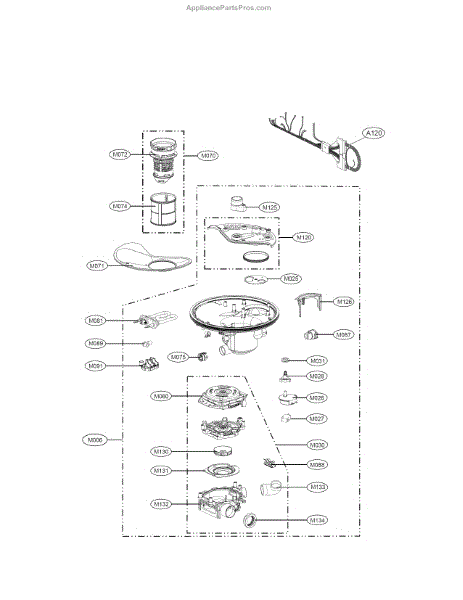

Part Number: W10549851
M025
By: Lg
Part Number: MJX61952001
This check valve controls one-way water flow to the appliance's dispenser and ice-making system, preventing backflow and helping maintain proper water delivery. Replaces worn or failed valves to restore normal water operation. What it does:
  • Allows water to flow in one direction to the dispenser/ice maker while preventing backflow
  • Helps stop intermittent dispensing, weak water flow, or water backing into supply lines
  • Prevents contamination from reverse flow when the system is idle
  • Works as a simple, direct-flow component in the water delivery path
  • One check valve
  • Turn off water supply and unplug the appliance before beginning work
  • Observe original valve orientation; install the replacement in the same direction
  • Tighten fittings securely and check all connections for leaks after restoring water

M026
4.7 (14)
By: Lg
Part Number: 4681ED3001D
The Diverter Motor Assembly is an OEM part for LG dishwashers. It is a critical component used to control the direction of water flow within the dishwasher, ensuring that water is properly diverted between the different spray arms during various wash cycles.
Symptoms of a failing Diverter Motor Assembly include:
  • Inadequate cleaning of dishes, with some areas remaining dirty
  • Unusual noises, like humming or clicking, indicating the diverter motor is struggling to operate
  • Error codes displayed on the dishwasher that relate to water distribution problems
  • Water not reaching all spray arms
Causes of a bad diverter motor can include wear and tear from regular use, electrical issues such as faulty wiring or motor failure, and mechanical obstructions or debris that prevent the diverter from moving smoothly.
This OEM LG part is also compatible with Sears/Kenmore models.
$52.95
M027
4.3 (6)
By: Lg
Part Number: 3W40025L
The Dishwasher Micro Switch is an OEM part for LG dishwashers. It plays a crucial role in detecting the door's position, ensuring the dishwasher only operates when the door is securely closed. This switch helps maintain safety and proper functioning during the wash cycle.
Causes of a bad micro switch can include wear and tear from regular use, electrical malfunctions, or physical damage. A compromised micro switch can prevent the dishwasher from starting or stopping correctly.
Symptoms of a bad dishwasher micro switch include:
  • The dishwasher not starting or stopping unexpectedly
  • Error codes related to door issues
  • The door not locking securely during operation
  • Unresponsive control panel or buttons
$16.75
M028
By: Lg
Part Number: MBJ61901901
If your dishwasher won't advance through cycles or gets stuck mid-cycle, this cam switch controls cycle sequencing. Restores proper cycle selection.
M030
By: Lg
Part Number: ABT72909202
Loud droning noise during cycles? A cracked pump casing causes leaks and poor water flow. Moderate DIY repair requires dishwasher removal and reinstall.
$274.34
M031
4.8 (18)
By: Lg
Part Number: 3920ED4009B
Seals the cam motor shaft to prevent water leaking into motor and electrical components. Replace if you notice leaks around the motor area or water damage.
M060
By: Lg
Part Number: 4681ED1004E
Fixes noisy wash cycles and dishes that won't come clean. This motor drives water through spray arms. DIY install takes 90 minutes with basic tools.
$199.68
M072
By: Lg
Part Number: ADQ73234005
Screens debris to protect components and maintain cleaning performance. Replace if torn, warped, or clogged to restore water flow. Confirm fit with model.
$37.95
M074
By: Lg
$37.95
M075
By: Lg
Part Number: ABQ73502701
Fix incomplete draining and pulsing sounds during drain cycles. This dishwasher check valve prevents backflow. Easy 30-minute DIY repair.
$17.52
M081
By: Lg
Part Number: AEG72950001
Fix HE or tE error codes and dishes not drying properly. This dishwasher heating element assembly heats water for washing and drying. Moderate DIY.
$107.95
M087
By: Lg
Part Number: 6501ED2002G
Fixes inconsistent cleaning and improper cycle timing caused by inaccurate water clarity detection. Measures soil level in wash water for optimal performance.
$63.57
M088
By: Lg
Part Number: 3740ED3003A
Cap cover for dishwasher assembly. Installs to protect internal components. Replace if cracked, broken, or missing to restore proper coverage.
$10.70
4.9 (421)
M089
By: Lg
Part Number: MEJ62284601
Joins dishwasher hoses to ports for leak-resistant connections. Replace this small connector if it's cracked, split, or loose to stop drips at the joint.
$23.95
M091
By: Lg
Part Number: EBF61334501
This is a safety switch assembly that helps ensure the dishwasher operates only under safe conditions, such as when the door is properly latched or water pressure is adequate. It sends a signal to the control board to allow or interrupt the wash cycle. Replace this switch if the dishwasher will not start, stops mid-cycle unexpectedly, or fails to fill with water properly.
$77.95
A120
By: Lg
Part Number: EAD61725002
Dishwasher not completing cycles or controls unresponsive? This wire harness connects heaters, pumps, and controls for proper communication. Moderate DIY.
$254.95
M120
By: Lg
Part Number: ABQ73502601
Direct-fit replacement dishwasher case assembly that secures and protects internal components. Replace your cracked, broken, or warped outer housing.
$48.95
M125
By: Lg
Part Number: MEG62080801
Dishwasher holder component that secures parts in place during wash cycles. Replace if cracked, broken, or missing to restore proper fitment and stability.
$14.39
M126
By: Lg
Part Number: MCK63312801
$13.26
M130
By: Lg
Part Number: AER72929001
Fixes poor spray or weak water circulation in your dishwasher. This impeller assembly restores proper water flow. Moderate DIY repair, 30-45 minutes.
$21.54
M131
By: Lg
Part Number: MBN61986201
This is the upper crankcase or housing that encloses the pump impeller assembly in the dishwasher. It provides a sealed chamber for the pump motor to circulate and drain water during wash and drain cycles. Replace this housing if it is cracked, leaking, or damaged, which can cause water leaks under the dishwasher or poor wash and drain performance.
$38.28
M132
By: Lg
Part Number: MBN62007101
This is the lower case housing for the dishwasher's circulation pump assembly. It encloses and supports the pump motor that recirculates water through the spray arms during wash and rinse cycles. Replace this housing if it is cracked, warped, or leaking water beneath the dishwasher during operation.
$101.95
M133
By: Lg
Part Number: MEJ61885701
Connects household water supply to your dishwasher. Replace if hose is kinked, cracked, dry-rotted, or leaking at connections. Installs at bottom.
$20.95
