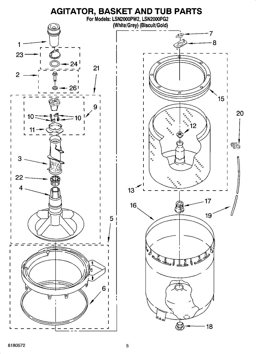

Parts for Whirlpool LSN2000PG2: 03 - Agitator, Basket And Tub Parts
