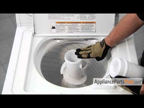

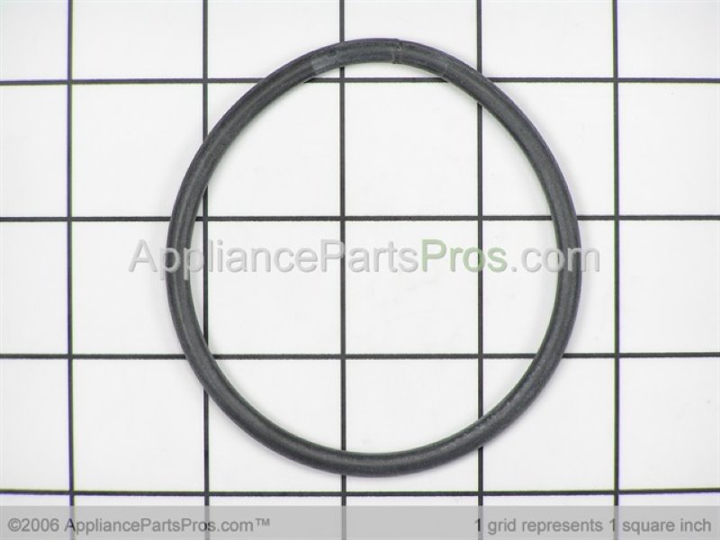

Richard P Brockton , MA November 14, 2014 Upper agitator on a whirlpool washer Replaced the upper agitator, the whole dogs unit, and the dust cover "o"-ring Read More... 10 People found this story helpful Do-It-Yourself Rating: Repair Time Estimate: 15-30 minutes Tools: Screwdrivers, Socket Set
Carl H Costa Mesa , CA March 06, 2015 Appliance: Maytag Washer MVWC200XW1 Dispener clogged and o ring became loose needed to replace Put in new parts after cleaning dispenser well in agitator column. Easy to do but takes some care to bottom out the inner cap assembly to keep the three distribution holes totally uncovered . All went well. Read More... 9 People found this story helpful Do-It-Yourself Rating: Repair Time Estimate: Less than 15 minutes

Natalie T Roosevelt , UT August 05, 2017 Agitator dogs worn & inner cap seal brittle. Replaced dogs & cap seal. I also replaced Spring retainer since it was worn and I had it apart. Easy repair. Used a screwdriver to pop off fabric softener cap. socket to remove the agitator. I used a flathead screwdriver to remove the spring from the retainer. I cleaned everything and reassembled. It was a very easy repair. Saved at least $100. doing it myself. Appliancepartspro.com is fast. I will buy from them in the future. Thanks guys! Read More... 2 People found this story helpful Do-It-Yourself Rating: Repair Time Estimate: Less than 15 minutes Tools: Screwdrivers, Socket Set
