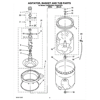

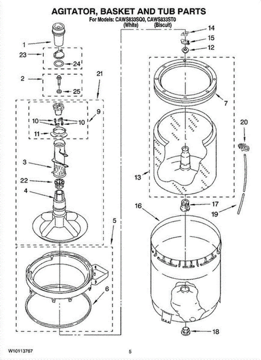

Parts for Whirlpool CAWS833ST0: 03 - Agitator, Basket And Tub Parts
