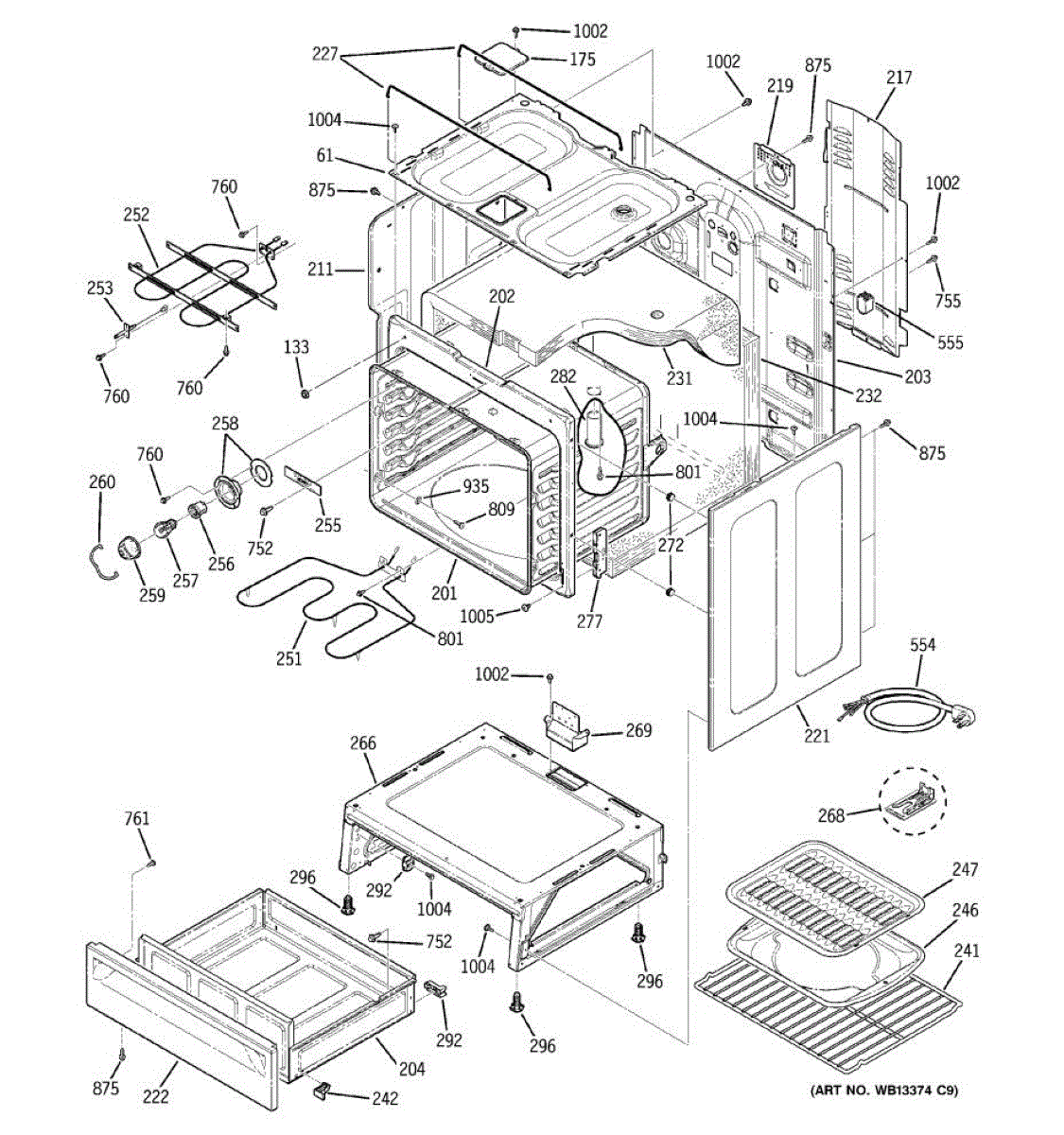

61
Part Number: WB64T10016
133
Part Number: WB02X29562
This rubber rangetop bumper cushions and supports the cooktop, reducing vibration and protecting the surface from metal-on-metal contact. It helps restore proper spacing and reduces rattling or chafing from loose or missing bumpers. What it does:
  • Cushions the cooktop edge to prevent scratching and wear
  • Keeps the cooktop and rangetop components properly spaced and stable
  • Reduces rattling, vibration, and noise during use
  • Commonly replaced when bumpers are cracked, flattened, missing, or allow movement
What's included: One rubber rangetop bumper. Install notes:
  • Remove power to the appliance and allow all surfaces to cool before servicing.
  • Access may require lifting or removing the cooktop; follow manufacturer instructions for your model.
  • Replace with the same style bumper to maintain proper fit and spacing.
  • Use care around sharp edges.
133
3.0 (1)
Part Number: WB01T10052
Seals and cushions your oven door to reduce vibration and rattling. Replace when worn to restore proper spacing and eliminate air leaks. Verify fit.
133
Part Number: WB01T10026
Door pad gasket creates a seal between your oven door and front panel. Replace if worn, cracked, or causing heat loss. Confirm fit with your model number.
$9.62
175
Part Number: WB02T10021
201
Part Number: WB63X20942
Replace your damaged range oven cavity body assembly. Restores the structural integrity of your oven compartment when the interior is cracked or chipped.
$376.95
202
Part Number: WB63T10093
Replacement front frame for your range. This structural component forms the outer cabinet edge. Order a new frame if yours is damaged, cracked, or warped.
$79.86
203
Part Number: WB63T10047
Main back panel for your range. Provides structural support and houses internal components. Replace if cracked, damaged, rusted, or warped from heat exposure.
$155.47
204
Part Number: WB55T10178
Replacement storage drawer lining for range drawers. Protects drawer floor and keeps items stable. Replace worn, stained, or missing liners.
$129.23
211
Part Number: WB02T10028
Retains insulation along the side panel of your range. Replace if the retainer is cracked, broken, or missing to properly secure insulation in place.
$21.54
217
Part Number: WB02T10532
219
Part Number: WB34T10011
The receptacle cover is a protective plastic or metal plate that snaps over an electrical outlet or port on your appliance. It shields the connection from dust, moisture, and accidental contact. Replace this part if the original cover is cracked, missing, or no longer snapping securely into place.
221
Part Number: WB63T10110
Bisque
$48.23
222
Part Number: WB56T10270
227
Part Number: WB02T10029
231
Part Number: WB35T10012
Used on the top and side outer cavity
232
Part Number: WB35T10113
Thermal insulation installs behind the oven liner to retain heat and protect surrounding surfaces. Replace when burned, contaminated, or damaged.
$43.60
241
4.9 (51)
Part Number: WB48T10011
Replacement oven rack for ranges. Holds cookware inside the oven cavity. Replace if cracked, warped, bent, rusted, or missing from a used appliance.
$59.25
242
Part Number: WB48T10068
Drawer wedge guide aligns and stabilizes your range's lower drawer for smooth operation. Replace if cracked, broken, worn, or missing to eliminate wobble.
$23.51
246
5.0 (51)
Part Number: WB48X10056
$34.95
247
5.0 (51)
$34.95
251
4.9 (540)
Part Number: WB44T10011
Oven not heating or baking unevenly? A faulty bake element is usually the cause. This bottom heating element is a straightforward DIY fix in 10-15 minutes.
$81.95
252
4.9 (110)
Part Number: WB44T10009
Oven won't broil or heat from the top? This broil element heats the upper oven cavity. Easy 15-30 minute DIY repair with a screwdriver and video guide.
$85.36
253
4.9 (141)
Part Number: WB21X22134
Fix F2 error codes and inaccurate oven temperatures by replacing a faulty temperature sensor. Simple 15-minute DIY repair with basic tools.
$23.95
255
Part Number: WB7X7175
256
5.0 (36)
Part Number: WB08T10026
Replace your range's light receptacle socket when the oven light flickers or won't turn on. Easy DIY fix restores proper bulb connection. Confirm fit by model.
257
4.9 (381)
Part Number: 8009
  • Dimming or flickering light
$19.55
258
Part Number: WB02T10037
Interior housing that supports and shields the oven lamp and lens assembly. Replace if cracked, broken, or damaged to keep the light secure and aligned.
258
Part Number: WB02T10027
Seals the oven light lens to the cavity, blocking heat and moisture from the assembly. Replace if worn, cracked, or the lens won't seal properly.
259
4.9 (47)
Part Number: WB36X192
Clear glass lens that protects your oven light bulb. Replace if cracked, broken, or cloudy to safely view cooking progress. Confirm fit with model number.
$18.95
260
4.7 (11)
Part Number: WB2X7694
$4.61
266
Part Number: WB63X28540
Range base rivet assembly that secures internal components. Replace if rivets are broken, missing, or causing loose structural connections in your range.
$95.57
268
Part Number: WB02T10137
269
Part Number: WB17T10021
Secures and organizes high-voltage wiring connections on your range chassis. Replace if cracked, broken, or missing to restore stable power contact points.
$20.95
272
Part Number: WB02T10034
This side support panel replaces a damaged or missing support on the appliance's side, helping secure and align the cabinet and trim so the unit sits solidly and looks finished after installation or service. What it does:
  • Provides structural support for the side of the appliance cabinet and adjacent trim
  • Helps maintain correct spacing and alignment next to countertops or panels
  • Replaces a bent, warped, or corroded panel
  • Reduces rattles or rubbing caused by a loose side assembly
  • One side support panel
  • Disconnect power; turn off gas supply before servicing
  • Carefully pull the unit forward for side access; support it to prevent tipping
  • Remove fasteners, transfer any clips/brackets from the old panel, and reinstall with existing hardware
  • Wear cut-resistant gloves and verify clearances and level before final tightening
$11.86
277
Part Number: WB10T10005
282
Part Number: WB38X33649
Replacement vent tube for electric ranges. Routes air from oven cavity to exterior vent. Order if original is cracked, damaged, or missing.
$19.68
292
Part Number: WB48T10013
Replaces a cracked or broken front drawer support on your range. This plastic guide installs on the front of the warming drawer to stabilize movement.
292
5.0 (36)
Part Number: WB02X33180
The Rear Door Support is an OEM replacement part for GE ranges. Located at the base of the range, this bracket provides weight-bearing support for the lower oven drawer. It facilitates smooth extension and retraction of the drawer.
Causes of faulty support can include cracks or fractures developing over extended use, worn joints unable to sustain drawer weight, or misalignment from repeated opening/closing stress.
Symptoms of a bad support include:
  • Loose or sagging lower oven drawer
  • Grinding or binding noises when operating the drawer
  • Difficulty fully extending or retracting the drawer
  • The drawer not sitting securely in a closed position
This OEM GE replacement part is also compatible with Hotpoint, RCA, and some Kenmore ranges.
$11.41
296
Part Number: WB02X10521
Adjustable leveling leg for electric ranges. Installs on the bottom corner of the unit. Replace if broken, cracked, or missing to level your range.
554
Part Number: WB08T10029
Replace your electric range's power cord if damaged, frayed, or missing. This cord connects your range to the wall outlet for electrical power.
$37.18
555
Part Number: WB18T10352
This is an electrical relay used in ranges and ovens to control power to specific components such as heating elements or fans. It switches circuits on and off in response to signals from the control board. Replace this relay if a burner or oven element fails to heat, heats intermittently, or if the relay is visibly burned or damaged.
$64.70
752
Part Number: WB1K5200
755
Part Number: WZ4X44D
Replacement mounting screw for securing panels, brackets, and components inside your appliance. Needed when original screws are stripped or missing.
$51.35
760
Part Number: WB1X536
$18.25
761
Part Number: WB1X5364
Secures components to your appliance chassis for a rattle-free fit. Replace missing, stripped, or corroded screws to keep panels and brackets aligned.
$10.33
801
Part Number: WB1M1
ST10-16 X 7/16"
$9.48
809
Part Number: WB1X1137
875
Part Number: WZ4X245D
$24.32
875
4.5 (6)
Part Number: WH2X930
Black. 8-18 AB HXW 3/8
935
Part Number: WB1K5174
Replace your missing, worn, or damaged range washer. This small metal component secures parts and assemblies throughout your oven, ensuring proper fit.
$3.78
1002
Part Number: WB01T10017
Replacement screw secures panels, brackets, and trim inside your oven or range. Restores tight fit when original hardware is missing, stripped, or damaged.
$11.86
1004
Part Number: WH2X941D
Package of 12
$19.03
1004
Part Number: WB01T10037
Replacement 8-18 x 7/16 screw for securing oven panels, trim, brackets, and control components. Ideal when original screws are missing, stripped, or damaged.
1005
Part Number: WB01T10008
