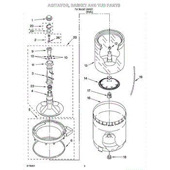

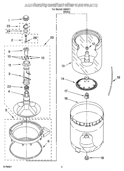

Parts for Whirlpool IJ44001: 03 - Agitator, Basket And Tub Parts
