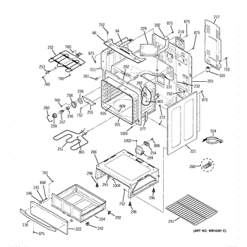

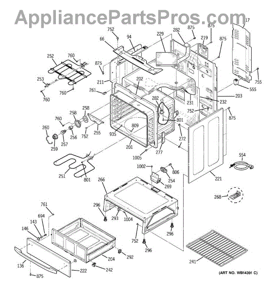

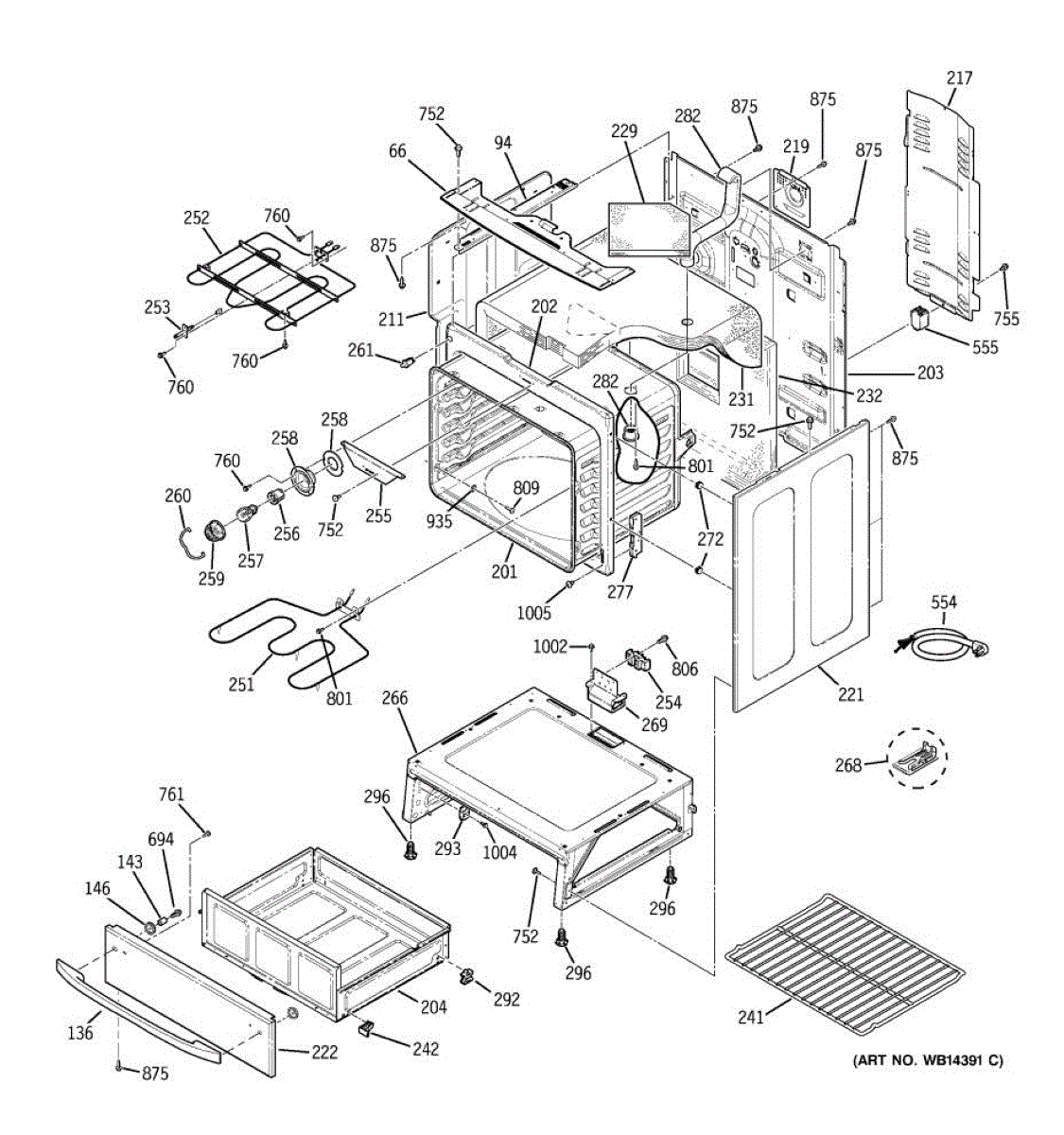

66
Part Number: WB34T10083
94
Part Number: WB02T10463
94
Part Number: WB34X26004
$13.18
136
Part Number: WB15T10141
White range door handle that mounts on the front of your oven door. Replace if your handle is cracked, broken, discolored, or missing for a complete look.
$60.62
136
Part Number: WB15T10138
143
Part Number: WB2X9037
146
Part Number: WB02T10065
201
Part Number: WB63X20942
Replace your damaged range oven cavity body assembly. Restores the structural integrity of your oven compartment when the interior is cracked or chipped.
$376.95
202
Part Number: WB63T10096
$51.95
203
Part Number: WB63T10147
204
Part Number: WB55T10178
Replacement storage drawer lining for range drawers. Protects drawer floor and keeps items stable. Replace worn, stained, or missing liners.
$129.23
211
Part Number: WB02T10275
$12.06
217
Part Number: WB02T10532
219
Part Number: WB34T10011
The receptacle cover is a protective plastic or metal plate that snaps over an electrical outlet or port on your appliance. It shields the connection from dust, moisture, and accidental contact. Replace this part if the original cover is cracked, missing, or no longer snapping securely into place.
221
Part Number: WB56X28884
White side panel for electric ranges. Replaces cracked, scratched, or rusted exterior panels. Restores cabinet appearance and protects internal parts.
$70.95
222
Part Number: WB56T10174
229
Part Number: WB35T10017
Insulation wrap for range vent tubes. Prevents heat transfer to cooktop surface. Replace if damaged, torn, or missing after rodent damage or wear.
231
Part Number: WB35T10209
$88.74
232
Part Number: WB35T10113
Thermal insulation installs behind the oven liner to retain heat and protect surrounding surfaces. Replace when burned, contaminated, or damaged.
$43.60
241
Part Number: WB48T10061
242
Part Number: WB48T10068
Drawer wedge guide aligns and stabilizes your range's lower drawer for smooth operation. Replace if cracked, broken, worn, or missing to eliminate wobble.
$23.51
251
4.9 (532)
Part Number: WB44T10011
Oven not heating or baking unevenly? A faulty bake element is usually the cause. This bottom heating element is a straightforward DIY fix in 10-15 minutes.
$81.95
252
Part Number: WB44T10012
Broiler stopped working or burned out? This range broil heating element restores even browning and high-heat cooking. DIY-friendly installation.
$110.62
253
4.9 (136)
Part Number: WB21X22134
Fix F2 error codes and inaccurate oven temperatures by replacing a faulty temperature sensor. Simple 15-minute DIY repair with basic tools.
$23.95
254
5.0 (12)
Part Number: WB17T10011
Range won't heat or burners stopped working? A burnt or melted terminal block may be the cause. This wiring connection hub routes power to elements. DIY repair in 10-20 minutes.
$58.95
255
Part Number: WB07T10517
Replace a broken range trim latch that won't secure trim panels properly. This latch keeps decorative trim aligned and in place on your range exterior.
$10.33
256
5.0 (32)
Part Number: WB08T10026
Replace your range's light receptacle socket when the oven light flickers or won't turn on. Easy DIY fix restores proper bulb connection. Confirm fit by model.
257
4.9 (376)
Part Number: 8009
  • Dimming or flickering light
$19.55
258
Part Number: WB02T10037
Interior housing that supports and shields the oven lamp and lens assembly. Replace if cracked, broken, or damaged to keep the light secure and aligned.
258
Part Number: WB02T10027
Seals the oven light lens to the cavity, blocking heat and moisture from the assembly. Replace if worn, cracked, or the lens won't seal properly.
259
4.9 (42)
Part Number: WB36X192
Clear glass lens that protects your oven light bulb. Replace if cracked, broken, or cloudy to safely view cooking progress. Confirm fit with model number.
$18.95
260
4.7 (11)
Part Number: WB2X7694
$4.61
261
4.9 (12)
Part Number: WB24T10147
This is a high-amp SPDT (single pole, double throw) switch used in the oven door mechanism. It detects whether the oven door is open or closed and signals the control to enable or disable certain functions such as the oven light or broil element. Replace this switch if the oven light does not turn on or off when the door is opened or closed, or if the oven does not operate correctly in relation to door position.
$23.34
266
Part Number: WB63X28540
Range base rivet assembly that secures internal components. Replace if rivets are broken, missing, or causing loose structural connections in your range.
$95.57
268
Part Number: WB02T10137
269
Part Number: WB17T10021
Secures and organizes high-voltage wiring connections on your range chassis. Replace if cracked, broken, or missing to restore stable power contact points.
$20.95
272
Part Number: WB02T10034
This side support panel replaces a damaged or missing support on the appliance's side, helping secure and align the cabinet and trim so the unit sits solidly and looks finished after installation or service. What it does:
  • Provides structural support for the side of the appliance cabinet and adjacent trim
  • Helps maintain correct spacing and alignment next to countertops or panels
  • Replaces a bent, warped, or corroded panel
  • Reduces rattles or rubbing caused by a loose side assembly
  • One side support panel
  • Disconnect power; turn off gas supply before servicing
  • Carefully pull the unit forward for side access; support it to prevent tipping
  • Remove fasteners, transfer any clips/brackets from the old panel, and reinstall with existing hardware
  • Wear cut-resistant gloves and verify clearances and level before final tightening
$11.86
277
Part Number: WB10T10068
Secures the oven door hinge to the range cabinet frame. Replace if cracked, bent, or damaged to restore proper door alignment and closure fit.
$24.22
282
Part Number: WB38T10022
Vent tube for electric ranges that channels heat away from oven components. Replace if cracked, damaged, or missing to restore proper airflow protection.
$30.48
282
Part Number: WB38X33648
Vent tube that channels hot air from your electric range oven to the exhaust path. Replace if cracked, warped, or missing to restore proper ventilation.
$15.59
292
5.0 (31)
Part Number: WB02X33180
The Rear Door Support is an OEM replacement part for GE ranges. Located at the base of the range, this bracket provides weight-bearing support for the lower oven drawer. It facilitates smooth extension and retraction of the drawer.
Causes of faulty support can include cracks or fractures developing over extended use, worn joints unable to sustain drawer weight, or misalignment from repeated opening/closing stress.
Symptoms of a bad support include:
  • Loose or sagging lower oven drawer
  • Grinding or binding noises when operating the drawer
  • Difficulty fully extending or retracting the drawer
  • The drawer not sitting securely in a closed position
This OEM GE replacement part is also compatible with Hotpoint, RCA, and some Kenmore ranges.
$11.41
293
Part Number: WB48T10013
Replaces a cracked or broken front drawer support on your range. This plastic guide installs on the front of the warming drawer to stabilize movement.
296
Part Number: WB02X10521
Adjustable leveling leg for electric ranges. Installs on the bottom corner of the unit. Replace if broken, cracked, or missing to level your range.
554
Part Number: WB08T10029
Replace your electric range's power cord if damaged, frayed, or missing. This cord connects your range to the wall outlet for electrical power.
$37.18
555
Part Number: WB18T10352
This is an electrical relay used in ranges and ovens to control power to specific components such as heating elements or fans. It switches circuits on and off in response to signals from the control board. Replace this relay if a burner or oven element fails to heat, heats intermittently, or if the relay is visibly burned or damaged.
$64.70
694
Part Number: WB1K5157
Hex washer head screw secures oven panels, brackets, and door handles. Replace missing, stripped, or damaged screws to eliminate looseness and rattling.
752
Part Number: WB1K5200
755
Part Number: WZ4X44D
Replacement mounting screw for securing panels, brackets, and components inside your appliance. Needed when original screws are stripped or missing.
$51.35
760
Part Number: WB1X536
$18.25
761
Part Number: WB1X5364
Secures components to your appliance chassis for a rattle-free fit. Replace missing, stripped, or corroded screws to keep panels and brackets aligned.
$10.33
801
Part Number: WB1M1
ST10-16 X 7/16"
$9.48
806
Part Number: WH2X1186
8-18 AB IHW 5/8 S
809
Part Number: WB1X1137
875
Part Number: WZ4X245D
$24.32
875
4.5 (6)
Part Number: WH2X930
Black. 8-18 AB HXW 3/8
935
Part Number: WB01T10112
$8.53
1002
Part Number: WB01T10017
Replacement screw secures panels, brackets, and trim inside your oven or range. Restores tight fit when original hardware is missing, stripped, or damaged.
$11.86
1004
Part Number: WH2X941D
Package of 12
$19.03
1005
Part Number: WB01T10008
