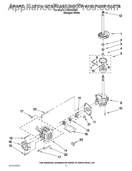

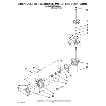

Parts for Whirlpool LTE5243DQA: 08 - Brake, Clutch, Gearcase, Motor And Pump Parts
