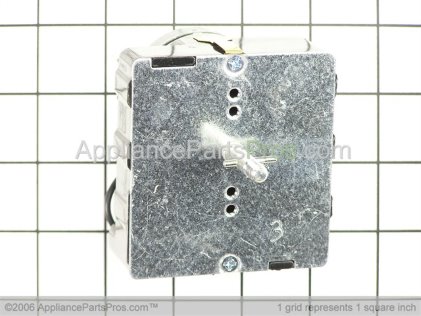

Scott W. December 11, 2011 for Model Number LDE312 I have read your questions on the timer for this model. I have the same problem that when turned to between more and less dry the timer does not have the clicking noise and will not advance until you manually turn it to below the less dry position. The serial number is 256833. Can you tell me if the timer is bad or something else is bad.
1 Answer Hello Scott. If the timer works in every other spot, but does not there, you will need to replace the timer WP305973. It is bad. Hope this helps. Read More...
