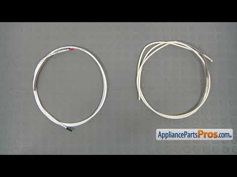

John N Akron , OH November 25, 2019 Appliance: Model LG -- LFX25978ST/01 Line to ice/drinking water had cracked at back of frig Ordered new tube part AJR56656503 for Lg LFX25978ST/01 watched a lot of videos but none showed how to remove the door tube end from its connection so I just cut and spliced the new tube to the old under the cover for the door hinge area after feeding it from the back of frig to that area. It was easy till I tried to remove the line end from ice maker area. Read More... 7 People found this story helpful Do-It-Yourself Rating: Repair Time Estimate: 30-60 minutes Tools: Screwdrivers
Edward L Youngwood , PA October 19, 2021 Appliance: Model 7858XVASW Water reservoir line. The repair went fine, however, I had to install the new line from the bottom of the door up to the top of the door and then through the refrigerator case to the back of the refrigerator completely opposite of the repair video. Everything is working fine now. Thank you for your help. Also, the door did not have a tank in it for the freshwater it had a coil of pipe. I had to cut the pipe from the coil and get a fitting to reattach the new pipe to the coiled pipe. Edward R. L. Read More... 4 People found this story helpful Do-It-Yourself Rating: Repair Time Estimate: 30-60 minutes Tools: Screwdrivers
Patrick A Norcross , GA May 19, 2020 Water leak. Replaced one hose and union with clip. Read More... 1 People found this story helpful Do-It-Yourself Rating: Repair Time Estimate: Less than 15 minutes Tools: Pliers, Screwdrivers
Michael W Duncan , SC June 06, 2022 Appliance: Model LG REFRIGERATOR The tube going to ice maker broke. Take the top hinge cover off of the door. Remove the connection for the hose from the rear of the refrigerator. Remove the bottom door shelf then remove the cover on the bottom of the door and disconnect the tube that comes down on the inside of the door. Pull the tubing out from the top of the door, then pull the tubing out from the back of the refrigerator. Take your new tubing and reverse the procedure. Read More... 1 People found this story helpful Do-It-Yourself Rating: Repair Time Estimate: 15-30 minutes Tools: Screwdrivers
Will S Edisto Island , SC March 20, 2022 Appliance: LG Refrigerator LFX25978ST/00 My water line was leaking, and decided to replace both of them. Pretty simple fix, swapping these two lines. It took more time moving the refrigerator away from the wall and removing the various panels than actually changing out the lines. Read More... Do-It-Yourself Rating: Repair Time Estimate: 15-30 minutes Tools: Screwdrivers
