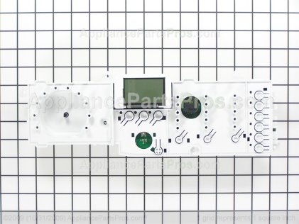

Geoff Darbyshire February 27, 2018 for Model Number EFME617STT0 I think this is the right model. The control knob which pushes onto a plastic spindle on the control panel is broken. The spindle sheared off. There is a number imprinted on the control panel plastic housing of 1349268 Does the control board come in one piece as i seem to see from some drawings that the control Knob and housing is separate? I see under the knob a circluar PCB with the rotary switch in the center carrying the turn spindle. I need to get to a fully working contraol panel but not sure of the parts needed?
1 Answer Geoff, Based on the model number you supplied, if " The control knob which pushes onto a plastic spindle on the control panel is broken. The spindle sheared off." You will need to order and replace the 5304508369 / 5304505020 Knob Assembly, complete, w/boards. The part is in stock and available at this time. Thanks, Read More...
