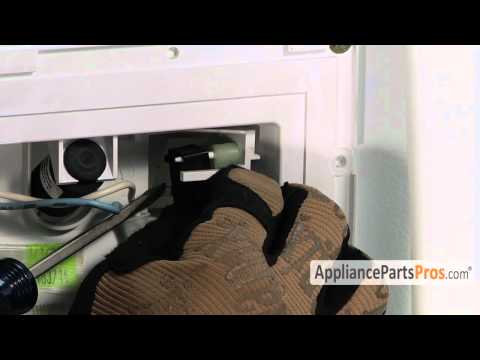

The Micro Switch is an OEM part for Whirlpool refrigerators that is responsible for controlling the ice and water dispenser. The switch operates by responding to mechanical actions, like the pressing of the dispenser paddle or button to open or close to allow water and ice to be dispensed.
Symptoms of a bad Micro Switch include:
Causes of a bad Micro Switch can include physical damage from heavy use, wear and tear over time, or electrical issues such as short circuits that impair the switch's function.

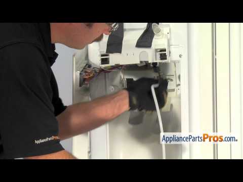

The Water Inlet Valve is an OEM replacement part for Whirlpool refrigerators. It regulates the supply of water to the ice maker and water dispenser features. Properly functioning valves are essential for reliably producing ice and dispensing filtered water.
Symptoms of a faulty inlet valve include:
Causes can involve mineral buildup overtime inhibiting flow control or a motor malfunctioning to switch the valve on and off.

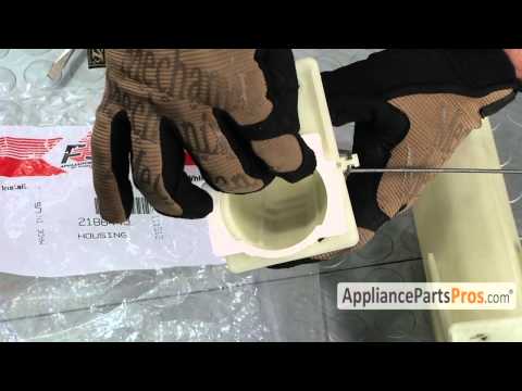

The Dispenser Lever Retainer is an OEM part for Whirlpool refrigerators. It secures the dispenser lever, which allows for the proper dispensing of water or ice when activated.
Causes of a bad dispenser lever retainer can include physical damage from repeated use, breakage due to accidental impact, or general wear and tear over time.
Symptoms of a bad dispenser lever retainer include:

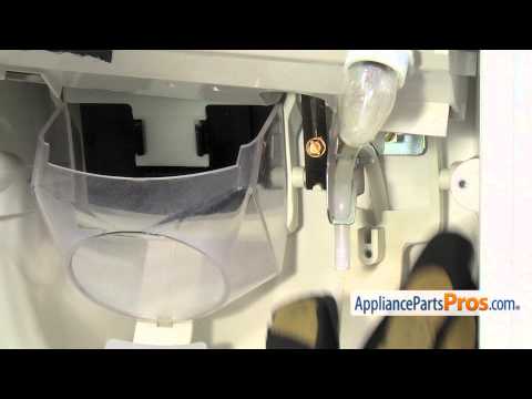

The Dispenser Water Tube Kit is an OEM part for Whirlpool refrigerators, designed to replace or repair the water line that connects to the refrigerator's water dispenser.
Causes of these symptoms can vary from normal wear and tear, mineral buildup from hard water leading to blockages or damage, or accidental damage during cleaning or moving of the refrigerator.
Symptoms of needing the Dispenser Water Tube Kit include:
