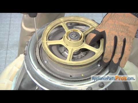

Cause #1 Thrust Bearing Kit
44%of the time
Total Satisfaction Rating (124)

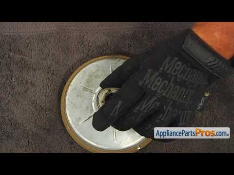

Cause #4 Brake Rotor
3%of the time
Total Satisfaction Rating (6)

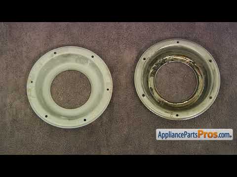

Cause #5 Snubber Ring
2%of the time
Total Satisfaction Rating (202)
