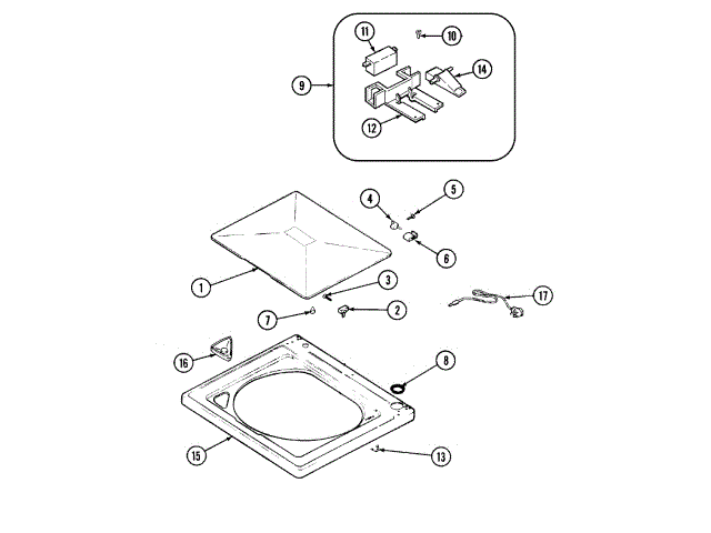

Cause #5 Lid Switch Actuator
4%of the time
Total Satisfaction Rating (2)
Cause #6 Lid Switch Assembly (Washer), Kit
Less than 1%of the time
Total Satisfaction Rating (1)
