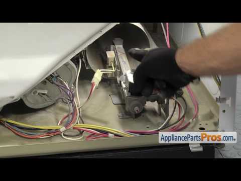

Maytag Dryer LDG8600AAW Takes too long to dry
Takes too long to dry is the 6th most common symptom for Maytag LDG8600AAW. It takes 15-30 minutes to fix on average. The instructions below from DIYers like you make the repair simple and easy. Many parts also have a video showing step-by-step how to fix the "Takes too long to dry" problem for Maytag LDG8600AAW. So, if your LDG8600AAW dryer takes longer to dry than normal, taking forever to dry or taking too long to dry clothes, the following info will help you identify the problem.

Cause #1 Dryer Cycling Thermostat
42%of the time
Total Satisfaction Rating (659)
Cause #2 Dryer Gas Valve Coil Kit
18%of the time
Total Satisfaction Rating (1824)
