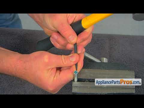

Judy J Lumberton , NC November 11, 2019 Wheels on refrigerator were damaged Used the video with the parts and replaced the wheels. The only thing we did wrong was using the front wheel axle instead of the back wheel axle on the back wheels. I will just order two more front wheel axles which are longer than the back axle. Thank you for the video, it made this repair easier. Read More... 4 People found this story helpful Do-It-Yourself Rating: Repair Time Estimate: Less than 15 minutes Tools: Adjustable Wrench, Pliers, Screwdrivers, Wrench Set
