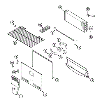

Parts for Admiral GT1713PXFW: 03 - Freezer Compartment Parts
