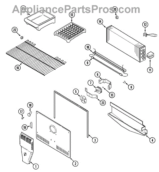

Parts for Admiral GT1787PKCW: 03 - Freezer Compartment Parts

This heater clip secures the defrost heater in your refrigerator. Keeping the element properly positioned helps the defrost system work as designed and reduces rattling or damage from a loose or misaligned heater.
  • Holds the defrost heater securely in place on its mounting point
  • Helps maintain correct heater placement for consistent frost removal
  • Replace if the clip is missing, broken, bent, or corroded
  • Common symptoms include a loose/dangling heater, rattling noises, or recurring frost/ice around the evaporator area
What's included: 1 heater clip Install notes:
  • Access the defrost heater behind the freezer's rear panel; note the original clip orientation
  • Install the new clip so the heater is seated and not contacting wiring or plastic; do not deform the element or coils
  • Restore power and verify the heater is secured in place

This defrost thermostat senses the evaporator coil temperature and controls the defrost heater. Replacing a failed thermostat restores proper defrosting to prevent heavy frost buildup and helps your refrigerator keep consistent, reliable cooling.
  • Monitors evaporator temperature to allow the defrost heater to energize and to terminate the cycle as the coil warms
  • Protects against overheating in the evaporator area during defrost
  • Failure symptoms include frost/ice buildup on the evaporator cover, reduced airflow, fresh food section warming, or the unit not defrosting
  • Typically mounts clipped to the evaporator tubing inside the freezer
What's included: One defrost thermostat Install notes:
  • Disconnect power before servicing and remove the freezer's rear panel to access the evaporator
  • Transfer the clip/bracket if present and mount the new thermostat in the same location, ensuring firm metal-to-metal contact with the evaporator tubing
  • Route wires away from the heater and moving parts; secure connections and reassemble panels before restoring power
  • Wear cut-resistant gloves—sheet-metal edges can be sharp
