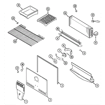

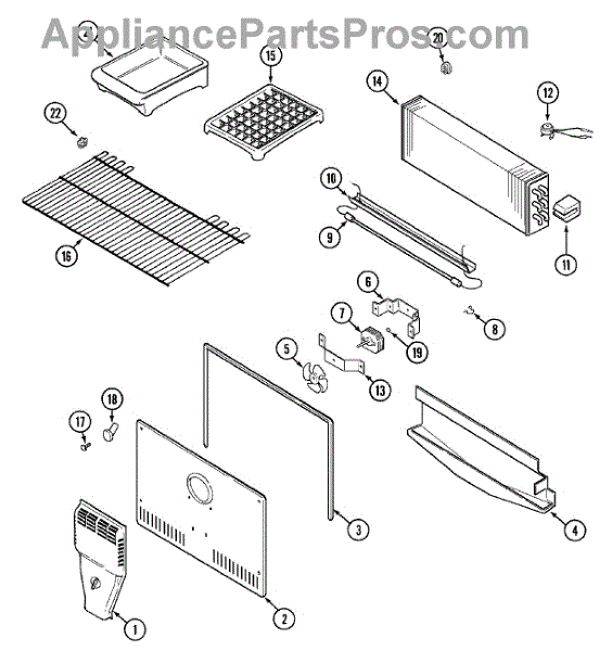

Parts for Admiral GT1924NEEW: 03 - Freezer Compartment Parts
