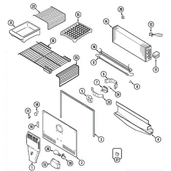

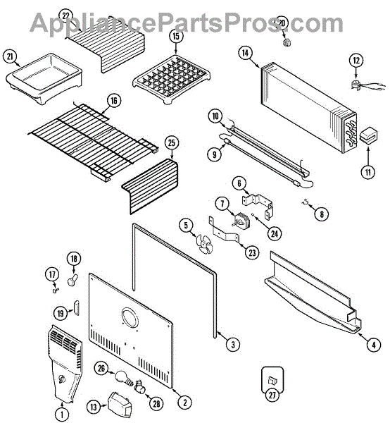

Parts for Admiral GT2616PXCW: 03 - Freezer Compartment Parts
