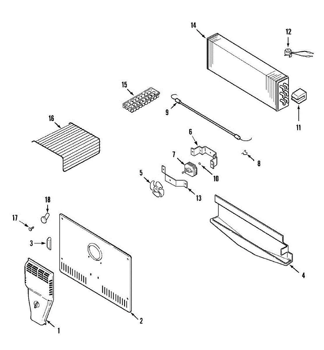

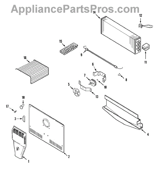

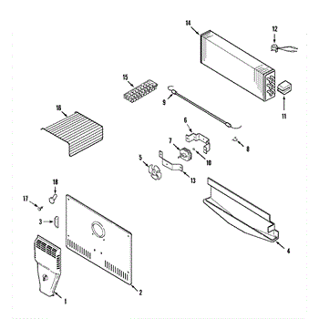

Parts for Amana ATB1915HRW: 03 - Freezer Compartment Parts
Size: 8 x 1-1/4 inch.
Size: 8-32 x .312 inch.

This evaporator fan motor circulates cold air across the evaporator coils and through the freezer and fresh-food sections to maintain even temperatures. Replacing a failed or noisy motor restores proper airflow and dependable cooling performance.
  • Drives the evaporator fan blade to move air over the coils and throughout the cabinet
  • Helps maintain consistent temperatures between freezer and refrigerator compartments
  • Failure symptoms include weak/no airflow, the fan not running, loud squealing/rumbling, or the fresh-food section warming up
  • Poor airflow can also lead to frost or ice buildup on the freezer back panel
What's included: 1 evaporator fan motor Install notes:
  • Disconnect power before servicing; wear cut-resistant gloves and eye protection
  • Access the motor behind the freezer's rear panel; use caution around sharp metal and evaporator fins
  • Note wire positions; transfer the fan blade and any brackets/grommets from the original motor; secure wiring connections
  • Ensure the blade spins freely; engage the door switch when testing and strong airflow after reassembly

This radiant defrost heater melts ice build-up on the evaporator coil so your refrigerator can maintain proper airflow and cooling. It restores normal defrost operation and helps prevent excessive frost accumulation. What it does:
  • Radiant heating element designed to melt frost and ice from the evaporator coil during the defrost cycle
  • Restores airflow and consistent cooling when the evaporator has been restricted by ice
  • Common symptom: visible frost or ice on evaporator or in freezer compartment
  • Common symptom: poor or uneven cooling, longer run times, or a freezer that cycles abnormally
  • One radiant defrost heater (single unit as shown)
  • Disconnect power to the appliance before servicing to avoid shock risk
  • Access typically requires removing the evaporator cover; handle evaporator fins and heater carefully
  • Inspect defrost thermostat/thermistor and defrost control components while replacing the heater — replace only the failed components

This defrost thermostat is the temperature limit switch for the evaporator. It lets the defrost heater run when coils are icy and opens as they warm to end the cycle, helping stop frost buildup and restore steady cooling.
  • Monitors evaporator temperature; closed when cold to allow the defrost heater to energize
  • Opens as the coil warms to terminate defrost and protect components from overheating
  • Failure may cause heavy frost on the back wall/evaporator and weak airflow or a warm refrigerator section
  • Can also lead to long run times or cooling that returns only briefly after a manual defrost
Includes: One defrost thermostat Install notes:
  • Unplug the refrigerator or disconnect power before servicing
  • Located behind the freezer's rear panel on the evaporator; remove shelves/ice bin and panel to access
  • Reinstall in the same position/clip for firm contact with the coil or tubing
  • Make secure, insulated wire connections and route wiring away from sharp edges and moving parts
Troubleshooting tip: At room temperature the thermostat should read open (no continuity); when chilled below freezing, it should read closed (continuity).

This replacement ice cube tray is a direct-fit plastic tray designed to hold and release ice cubes in compatible top- or bottom-freezer refrigerators. Restores convenient ice storage and simple manual ice removal. What it does:
  • Holds water in separate cavities so ice cubes form evenly.
  • Flexes slightly for easier ice release to reduce twisting or chipping.
  • Replaces cracked, warped, or missing trays that cause leaking or uneven freezing.
  • Helps prevent contamination from freezer debris when used as intended.
What's included: One plastic ice cube tray. Install notes:
  • Remove old tray and wipe area clean before installing the new tray.
  • Fill tray with water on a level surface and place flat in the freezer to freeze.
  • Handle carefully when removing ice to avoid spills; do not force with sharp tools.
  • Clean tray before first use and as needed; follow refrigerator manufacturer's care guidance.
