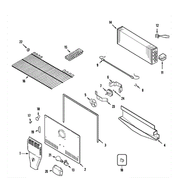

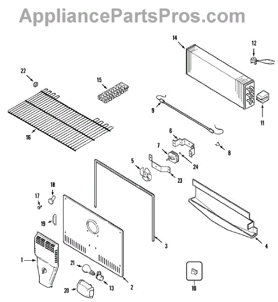

Parts for Amana ATB1935HRW: 06 - Freezer Compartment Parts
