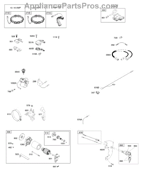

This is a magneto armature, also known as an ignition coil. It consists of a large rubber housing with an aluminum mounting armature and an electrical lead cable. An ignition coil is an electronic part that converts low-voltage power from an engine flywheel to high-voltage power for a spark plug. When the ignition coil has failed, the motor will not start. Early signs of failure include motor stalling, especially at lower speeds. These can also be symptoms of a dirty carburetor, so that should also be checked. To test an ignition coil, disconnect it from everything except the spark plug, then disconnect the spark plug boot. Insert a multimeter inside the boot, with the other contact on the metal coil housing. If it reads between 2,500 and 5,000 ohms, the ignition coil is working. If it shows an infinity or 1, the coil has failed. This is an OEM part sourced directly from the manufacturer, and it is sold individually. Designed for Briggs & Stratton motors, it has also been used on Toro machines and replaces older part numbers 492341, 495859, and 491312.

This genuine starter solenoid transfers electrical current from the battery to the starter during the engine starting process, allowing the engine to engage. This part could become worn over time or develop electrical malfunctions, which could eventually lead to a need for a full replacement. In the event that the solenoid goes bad, it could result in poor engine performance or not permit the engine to start at all. This replacement part could provide an exact fit for compatible lawn and garden units. This genuine OEM solenoid from Briggs & Stratton is manufactured to exact specifications. It is compatible with engines used in select models of generators and other lawn and garden equipment made by the brand. This genuine OEM part is sold individually and does not include any hardware or additional components. It is imperative to disengage the spark plug and allow the engine to cool before performing engine repairs like replacing the starter solenoid. A wrench or socket set will be required to disconnect the old solenoid and install the new unit and gloves should be worn for hand protection.

An ignition key set is used with a variety of lawn and garden equipment. When it's turned in the ignition slot, it will start the lawnmower, pressure washer, or other equipment. This set comes with two keys and a keyring to make it less likely that one will be lost. Ignition keys sometimes become damaged or broken and some people lose them, which means a replacement set is required.If a set of keys is lost or has been damaged, a new set will be needed to operate a lawnmower or other equipment. There is no installation process involved, so there's no need for additional tools. Once the replacement ignition key set is acquired, it can be used to get equipment back up and running. Simply turn the key to engage the motor and the lawn equipment will be ready to use.This ignition key set is designed for use with lawnmowers, wood chippers, snowblowers, generators, tillers, and pressure washers. It is compatible with equipment from Briggs & Stratton, Simplicity, Craftsman, Snapper, Cub Cadet, and Murray. This is a genuine OEM replacement part that comes as an individual component that consists of two silver keys on a ring.

This brush retainer is part of the starter motor on many types of lawn and garden machinery. It comes with both the retainer and a set of four brushes. The main job of the brush retainer is to hold a set of carbon brushes against the commutator bars located on the armature. If the brush retainer is worn, damaged, or improperly seated, it can cause problems with the equipment. The starter motor will not be able to get the proper amount of current from the battery.If the brush retainer might be causing problems, a visual inspection can be performed. A damaged brush retainer can wear down to the wire lead and become burned, pitted, or cracked. When the brush retainer is worn out, it can decrease engine performance, reduce braking, and cause the motor to lose power. This brush retainer is an authentic OEM replacement part sourced directly from the manufacturer. It is sold as an individual part. The retainer is made to be used with lawnmowers, snowblowers, tillers, and wood chippers created by Briggs & Stratton, Craftsman, Toro, Cub Cadet, Lawn-Boy, Snapper, MTD, and Simplicity.
